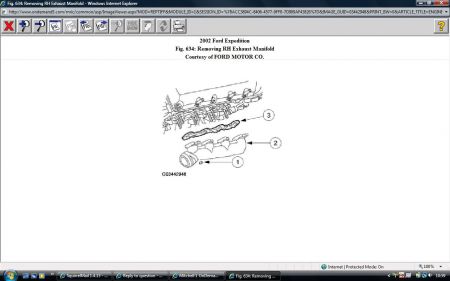

how to change?
Jan 10, 2009 at 1:40 AM
DAVE H
  • 13,384 POSTS
Remove the RH exhaust manifold. Remove the nuts. Remove the RH exhaust manifold. Remove the RH exhaust manifold gasket. Fig. 592: Removing RH Exhaust Manifold Courtesy of FORD MOTOR CO.
https://images.2carpros.com/forum/automotive_pictures/266999_exh_1.jpg
LH cylinder head Remove the LH exhaust manifold. Remove the nuts. Remove the LH exhaust manifold. Remove the LH exhaust manifold gasket.
