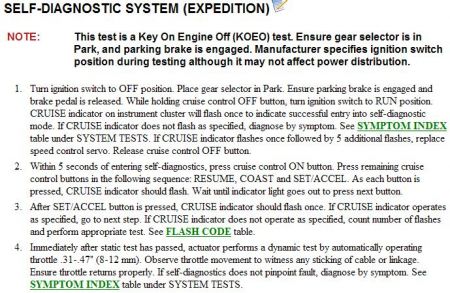

Try this test out and let me know the results. this does not require any special diagnostic tool.
https://www.2carpros.com/forum/automotive_pictures/261618_Noname_909.jpg
https://www.2carpros.com/forum/automotive_pictures/261618_Noname2_241.jpg

When running the diagnostic test, we did get a cruise light to let us know we was in the diagnostic mode but it then continued to flash"cruise" at regular intervals. We went on to the second test and when we hit the "on" button, we had a "cruise" light but had no lights for the "resume", "coast" and "set/accel" buttons. Does that indicate that switch is bad?
Monday, September 7th, 2009 AT 6:54 PM
BLUELIGHTNIN6
  • 16,542 POSTS

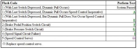

Did the "cruise" light flash once, then 5 additional times when you say it continued to flash? If so, it indicates a faulty speed control servo. Be sure to follow step 2 within 5 seconds of entering the diagnostic mode.
+1
Monday, September 7th, 2009 AT 7:34 PM
YVONNE151
  • 5 POSTS
It did flash once and then continued to flash about every 5-10 seconds apart from flash to flash. As long as we held the button in, it continued to flash. We wasn't sure if it was suppose to be 5 quick in succession flashes or spaced apart like mine was.
+2
Tuesday, September 8th, 2009 AT 4:03 PM
BLUELIGHTNIN6
  • 16,542 POSTS
Ok, it will probably be best to have the vehicle scanned with a diagnostic tool. This will prevent a misdiagnosis and save you a lot of time as well.
