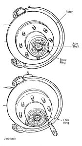

I need to replace the fromt brake rotors. I have removed the brake caliper and the caliper mounting bracket from the backing plate. The rotor seems to be rusted on the hub and wont come off. I have tried WD40 and applying heat to try to dislodge, then using a hammer on the back side of the rotor to try loosen it up.....with no luck. It does not seem that the rotor is pressed on the hub.....

Is it possible that the rotor and hub on this (4WD) truck is a one piece assembly. Not sure if the brakes or rotor on this truck has ever been changed. I have been taking a slede hammer to the back of the rotor to try to free it from the hub but without success. The caliper and caliper braket have been removed.....Help! Thanks

Does the vehicle have dual rear wheels .. this is the only other description I have ? Removal (Excursion & Super Duty Pickup - 4WD) Raise and support vehicle. Remove wheel. Remove anchor plate and caliper assembly. See DISK BRAKE CALIPERS & PADS. On models with single rear wheels, remove rotor.****** On models with dual rear wheels, remove hub plate extender nuts, and remove hub extender plate. See Fig. 8. Remove rotor.****** NOTE:If excessive force is used when removing rotor, it should be checked for lateral runout prior to installation. See ROTOR under OVERHAUL. Fig. 8: View Of Front Hub & Rotor Assembly (Super Duty Pickup - 4WD With Dual Rear Wheels)
