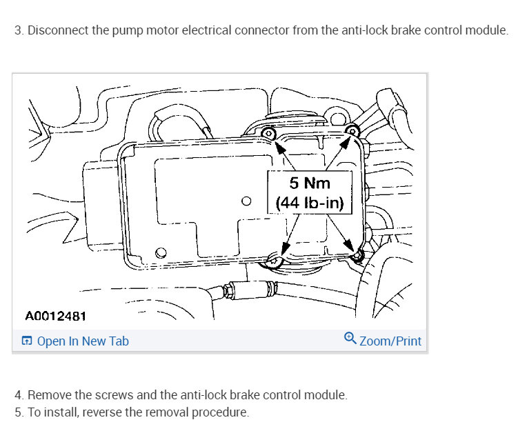

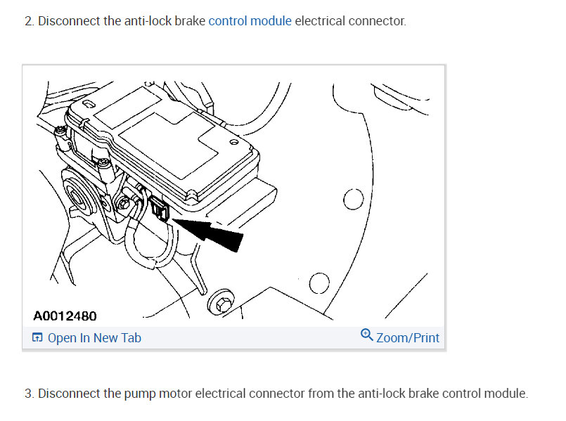

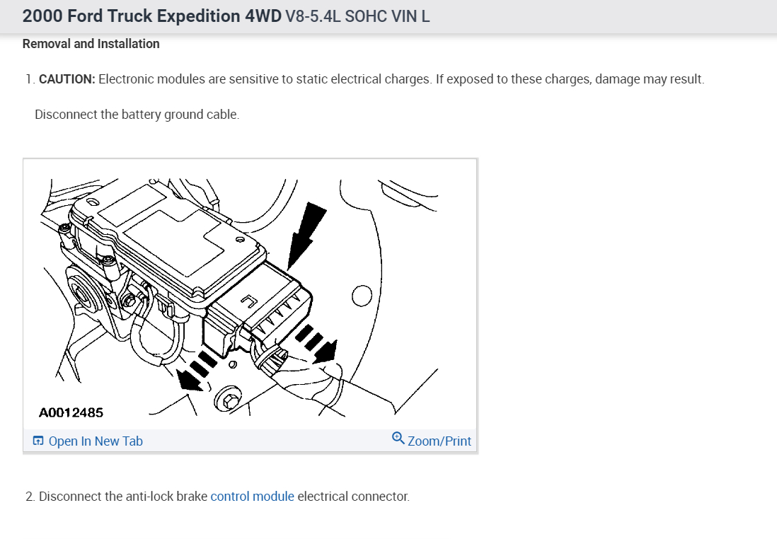

Where is it??!! How do I get to it and disconnect it. UGH Please help me because it has run my battery dry. My thinking is, if I can disconnect it and get a jump start I can get it to my mechanic and avoid a towing expense.
Jul 26, 2010 at 3:34 PM
BLUELIGHTNIN6
  • 16,542 POSTS
The ABS control unit will hold the ABS pump motor on so I would replace it here is the location and how to do the job in the images below. Here is how to change it out and you can get a rebuilt unit by checking RockAuto.com
