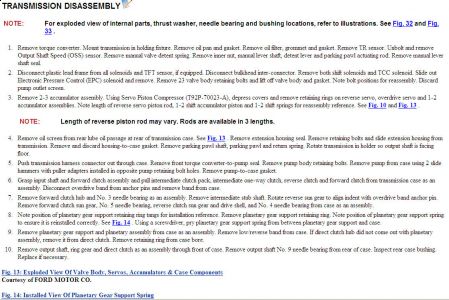

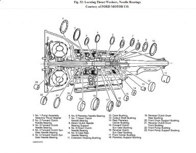

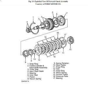

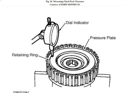

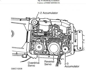

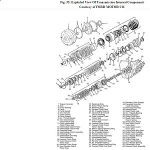

2000 Ford Expedition V8 Two Wheel Drive Automatic

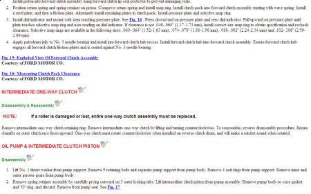

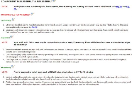

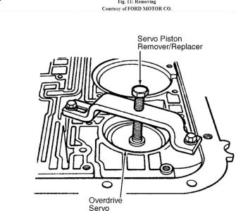

i need a diagram or manuel for overhauling a 4r70w transmission preferrably free
Aug 3, 2009 at 4:01 PM
SERVICE WRITER
  • 9,123 POSTS
It would be worth getting a subscription to mitchell1 as there is quite a bit of work to send it all. But I'll give you what you need as best I can.
https://images.2carpros.com/forum/automotive_pictures/30961_exp1_4.jpg
https://images.2carpros.com/forum/automotive_pictures/30961_exp10_1.jpg
https://images.2carpros.com/forum/automotive_pictures/30961_exp11_1.jpg
https://images.2carpros.com/forum/automotive_pictures/30961_exp32_1.jpg
https://images.2carpros.com/forum/automotive_pictures/30961_exp33_2.jpg

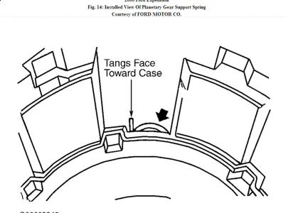

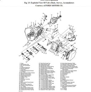

Aug 4, 2009 at 11:23 PM
SERVICE WRITER
  • 9,123 POSTS
Check your email
https://images.2carpros.com/forum/automotive_pictures/30961_exp2_2.jpg
https://images.2carpros.com/forum/automotive_pictures/30961_exp3_2.jpg
https://images.2carpros.com/forum/automotive_pictures/30961_exp13_1.jpg
https://images.2carpros.com/forum/automotive_pictures/30961_exp14_1.jpg
https://images.2carpros.com/forum/automotive_pictures/30961_exp15_1.jpg
https://images.2carpros.com/forum/automotive_pictures/30961_exp16_1.jpg
