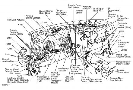

where is the air bag sensor location?

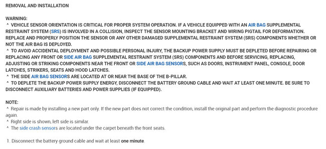

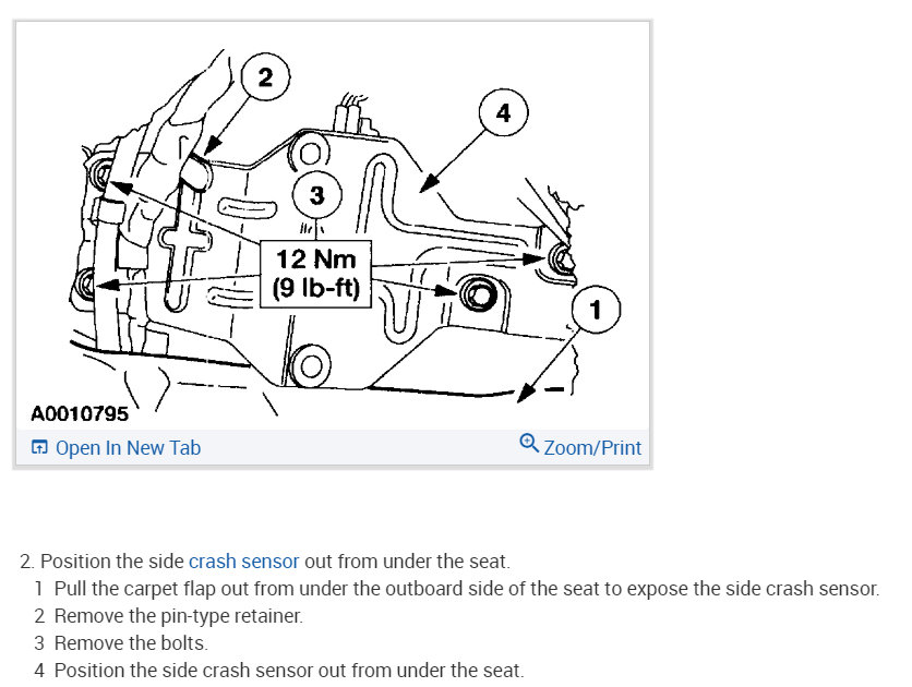

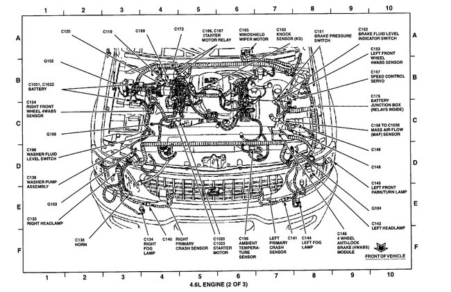

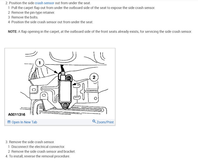

Which sensor? there are several impact sensors for the SRS or are you talking about the level ride system for the suspension? Here are the sensors for the airbag safety system. Check out the diagrams (Below). Please let us know if you need anything else to get the problem fixed.

air bag module sensor thats strictly for air bag.location is my question.2000 ford exp

2000 Ford Expedition 4 cyl 18900 miles

what is the actual fault with the vehicle ?? maybe we can help further ? Restraints Control Module (RCM)......Behind right side of dash. See Fig. 3 . Air Bag Sliding Contact ......At base of steering column. See Fig. 3
