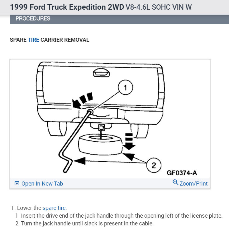

How to lower spare tire?
1999 FORD EXPEDITION
80,000 MILES • V8 • 4WD • AUTOMATIC
THEB2B
Where is the mechanism located to lower spare tire?
Feb 23, 2009 at 10:49 PM
  • 110,244 POSTS

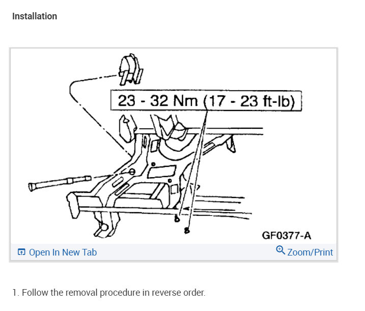

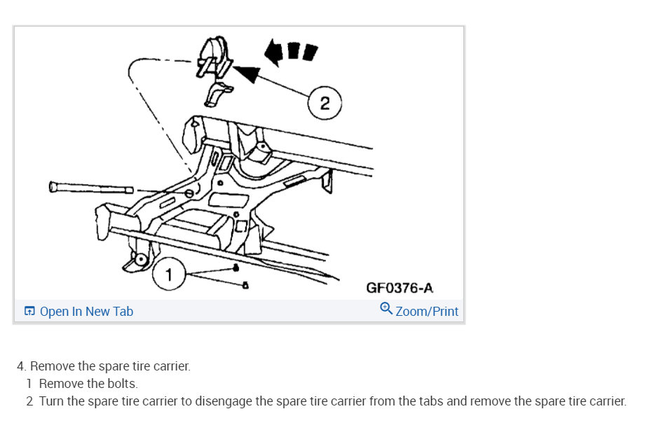

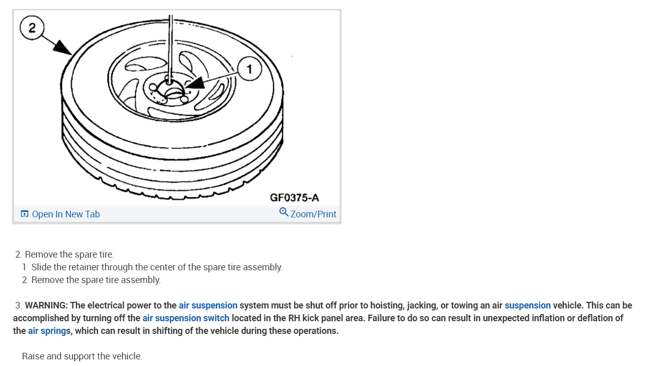

Open the liftgate. Just above the rear bumper is the guide tube. It may have a plug covering it. Insert the straight end if the jack handle into the tube. Turn it counterclockwise to remove. Pushing it in, turn it until you feel resistance. Once you feel it, turn the handle counterclockwise until the tire is lowered. Reverse the order to replace. Check out the diagrams (Below). Please let us know if you need anything else to get the problem fixed.
