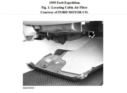

V8 two wheel drive automatic. Where is the cabin air filter? I see one in the rear when I open the hatch. It smells like there is on under the dash. How do I change this one?

Hello BONNETMK, To replace the cabin air filter follow this guide to let you know what you are in for in this job. It is located under the right side of the instrument panel in the HVAC housing. Trim panel may have to be removed to gain access to filter. See Fig. 1.

Follow this guide. https://www.2carpros.com/articles/how-to-change-an-air-cabin-filter Most of these cars do not have one so do not be surprised. Please let us know happens so it will help others. Best, Ken

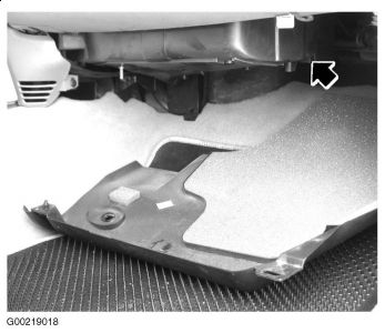

Hi there, Removal and Installation: Cabin air filter is available as an optional dealer-installed kit. Cabin air filter installation instructions are included with the kit. If a filter is already installed, it is located under the right side of the instrument panel in the HVAC housing. Trim panel may have to be removed to gain access to filter
https://images.2carpros.com/forum/automotive_pictures/61395_Capture1_5.jpg
https://www.2carpros.com/articles/how-to-change-an-air-cabin-filter Most of these cars do not have one so do not be surprised. Cheers, Mark (mhpautos)

You probably do not have on your truck as this is a dealer install option. So unless it was ordered it does not have one. Now if it does it is located under the right side of the instrument panel. So remove the lower panel and check to see if you have one.

How to remove trim panel? (Cannot find any screws) Do I need any special tool (kit)?

The red circle indicates where the cover is clipped on. Pull it downwards to get the clip off and you can see the cover for the cabin filter.
