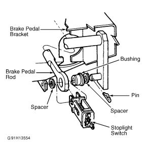

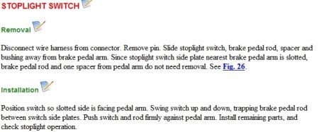

How do recognize the Brake Light Switch, and how do I go about adjusting or replacing the switch?

https://images.2carpros.com/forum/automotive_pictures/261618_Noname_1929.jpg
https://images.2carpros.com/forum/automotive_pictures/261618_Graphic_418.jpg
