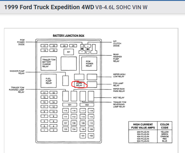

The horn in my vehicle doesn't operate. I've already checked the fuse in the box under the hood and the fuse is fine. What is my next step?
Dec 31, 2009 at 10:33 AM
SQM
  • 6,383 POSTS

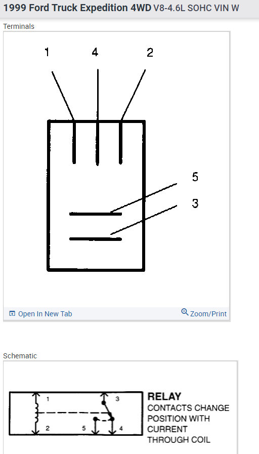

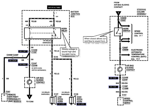

There is a relay associated with the horn of this vehicle.
It is located in the junction box under the hood (see diagram).

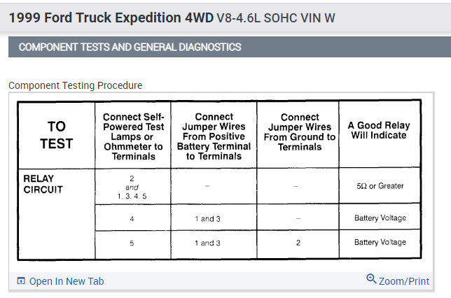

Visually inspect the relay for any corrosion or bunt pin(s).
You can also test the functionality of the relay.
You also want to make sure that you are getting power to the relay. If the relay is good then check to see if you have power to the connector that plugs into the horn. If you have power then it is a faulty horn.
