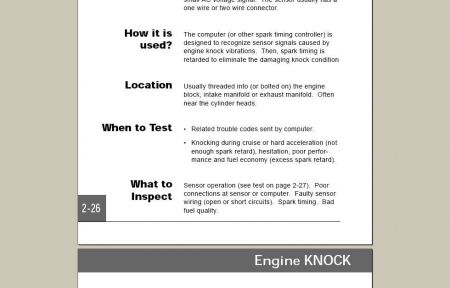

The Knock Sensor's purpose is to retard the ignition timing when the engine starts detonating/pinging/knocking. it will mess with driveability/performance and at the end damage the engine if ignition timing is not controlled when needed.
https://images.2carpros.com/forum/automotive_pictures/12900_Knock_Sensor_driveability_problems_1.jpg
