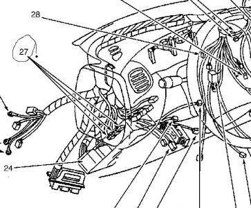

wipers come on intermittantly even with wiper switch in off position---where is the relay/controller for the wipers located? somewhere in the dashboard?
I have dismantled one of these dashes before to replace a heater core but I don't know which relay is the one I need to replace

The wipers High/low relay its located on left side of engine compartment in power distribution box.

Hello Again.. If the relay its good I would check the GEM (generic Electronic Module) because all of the wipers functions are controlled by that. The GEM is located behind center of instrument panel. Number 27:
https://images.2carpros.com/forum/automotive_pictures/576_Expedition_97_1.jpg
