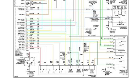

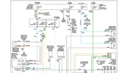

I engaged the front end manually & ty wraped, no lights come on the dash, no low range either.
One was ground,another was dash lights, there are 2 dark blue in the center.
(1) should there be power at the switch?
Any other knowledge on this would greatly appreciated !!!
(2) Any ways to test acuator on transfer case?

It will not go into 4-wheel drive or 4 low, no lights come on either. The vacuem soliniods are not working, with my vacuem pump the axles engage & disengage with no problem,I manually engaged the front axles & ty-wrapped engaged, to rule that out. Should I have power at the dash selector ? I have a Innova 3140 Scan Tool, can this help me ? There is no sounds from the motor on the transfer case when moving the selector on the dash, that is why I started with the fuses & then the switch. Any diagrams of the wiring would help also.

If the scanner can be used to retrieve DTCs and read data streams, it might possibly work but I am not sure about that. I will provide you the wiring schematics and see if you can come up with anything.
https://images.2carpros.com/forum/automotive_pictures/192750_TransferWiring97Expedition01a_1.jpg
https://images.2carpros.com/forum/automotive_pictures/192750_TransferWiring97Expedition01b_1.jpg
If you need additional info, feel free to ask and I will try to get them for you.
