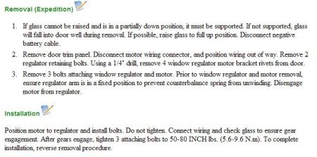

how do I replace the window regulator on the drivers front side??????????
