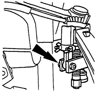

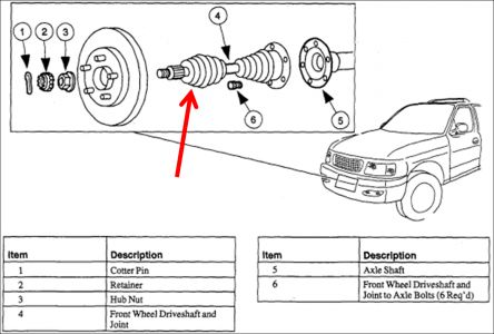

It appears that my front CV axles are broken into 2 sections that are subdivided by a round plate with bolts all around it. The cv boot nearest the wheel on my expedition has come off, and that section needs now to be replaced. Is it possible to simply undo all the bolts in this mid section, and remove the portion from that point to the wheel? Or does the entire assembly from the outer hub nut to the front gear box need to be replaced as one unit?
I'm hoping that all I need to do is undo th ebolts in the mid section, undo the hub nut, and the section will come out easily. Will I need to do anything on the wheel end apart from removing the Outter hub nut? I know it's good practice to replace bearings, and will most likely do this, but is removing them a necessity?

Hello - I have attached a pic that I am going to reference to make sure I am on the same page as you are. If I understand you correctly, the boot with the red arrow has come off.
https://images.2carpros.com/forum/automotive_pictures/248015_1_159.jpg
You want to remove and replace the entire shaft, item 4 in the pic....... Yes, that is how you do it. I have attached the info on how to do this. As you said, you have things apart; you may consider going a little more and replacing the bearings. They have been on there for over 100K. I call that preventive maintenance. Removal and Installation Notes REMOVAL Loosen the lug nuts. (1) Remove the center cap. (2) With the weight of the vehicle on the wheels, loosen the lug nuts. CAUTION: Do not use heat to loosen a seized lug nut. Heat can damage the wheel and the wheel bearings. Raise and support the vehicle. WARNING: THE ELECTRICAL POWER TO THE AIR SUSPENSION SYSTEM MUST BE SHUT OFF PRIOR TO HOISTING, JACKING OR TOWING AN AIR SUSPENSION VEHICLE. THIS CAN BE ACCOMPLISHED BY TURNING OFF THE AIR SUSPENSION SWITCH LOCATED IN THE RH KICK PANEL AREA. FAILURE TO DO SO MAY RESULT IN UNEXPECTED INFLATION OR DEFLATION OF THE AIR SPRINGS WHICH MAY RESULT IN SHIFTING OF THE VEHICLE DURING THESE OPERATIONS. Remove the wheel and tire assembly. (1) Remove the lug nuts. (2) Remove the wheel and tire assembly.

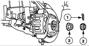

Remove the hub nut. (1) Remove the cotter pin. (2) Remove the retainer. (3) Remove the hub nut.

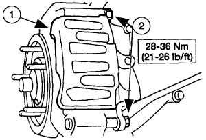

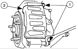

Position the front disc brake caliper aside. (1) Remove the two caliper bolts. (2) Lift the front disc brake caliper off the front disc brake caliper anchor plate and position aside.

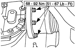

Remove the six front wheel driveshaft and joint bolts.

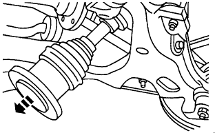

Separate the front wheel driveshaft and joint from the hub and remove the front wheel driveshaft and joint from the vehicle. CAUTION: Use caution to avoid damaging the hub seal when removing the front drive halfshaft.
https://images.2carpros.com/forum/automotive_pictures/248015_8_9.gif
INSTALLATION Install the six halfshaft bolts.
https://images.2carpros.com/forum/automotive_pictures/248015_9_8.gif
Install the caliper.
https://images.2carpros.com/forum/automotive_pictures/248015_10_7.gif

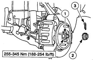

Install the front axle hub. (1) Install the front axle hub nut. (2) Install the retainer. (3) Install the cotter pin.
https://images.2carpros.com/forum/automotive_pictures/248015_11_7.gif
