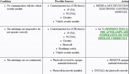

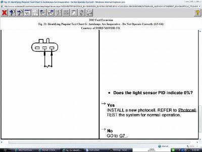

I have a 2002 ford excursion 4 wheel drive 7.3 turbo diesel the automatic lights have stopped working all lights work with the switch except the automatic feature I have checked the fuses and have found none bad and checking the manual I am unable to locate a fuse or relay labeled automatic lights.
Any help would be great.

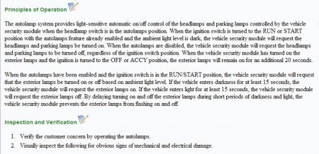

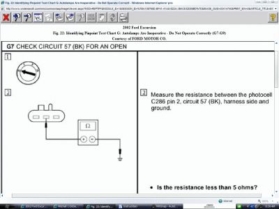

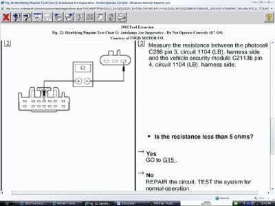

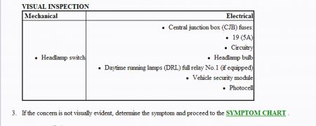

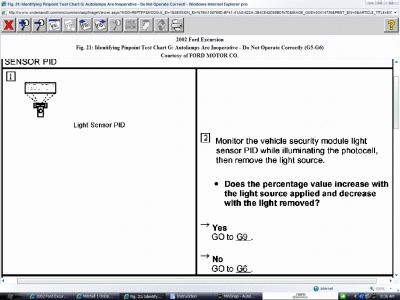

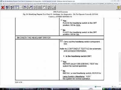

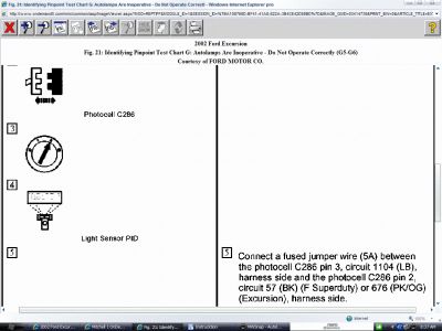

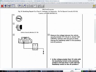

This may be too much help, but here goes!:
https://images.2carpros.com/forum/automotive_pictures/62217_Autolampsa_1.jpg
https://images.2carpros.com/forum/automotive_pictures/62217_Autolampsb_1.jpg
https://images.2carpros.com/forum/automotive_pictures/62217_Autolampsc_1.jpg
https://images.2carpros.com/forum/automotive_pictures/62217_Autolampsd_1.jpg
https://images.2carpros.com/forum/automotive_pictures/62217_Autolampse_1.jpg
https://images.2carpros.com/forum/automotive_pictures/62217_Autolampsf_1.jpg
https://images.2carpros.com/forum/automotive_pictures/62217_Autolampsg_1.jpg
https://images.2carpros.com/forum/automotive_pictures/62217_Autolampsh_1.jpg
https://images.2carpros.com/forum/automotive_pictures/62217_Autolampsi_1.jpg
https://images.2carpros.com/forum/automotive_pictures/62217_Autolampsj_1.jpg
May 3, 2008 at 8:00 AM
