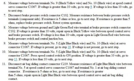

My cruise was working and then it got to where it only worked some times and now it does not work at all. It appears it is not coming on, I do not get anything when I try to turn it on and set it. The fuse that operates control is good as other components on same fuse work.
Any suggestions?
