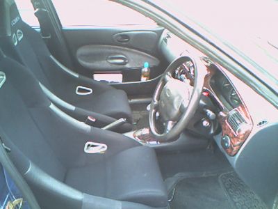

yeah thanks suffered one not long back when i lowered it, toatally hammered my motor. i ended up changing everything wishbones, struts and springs, bushes etc everything part from track rod ends. Took it down the local ATS to get it laser tracked and alligned turned out to be the damed track rod ends. so ive changed them and it's all sweet, at last!!! " Thank's again" .
https://images.2carpros.com/forum/automotive_pictures/57964_cumpfy_1.jpg
:D :wink:

Holy crap...do you live in England or deliver mail :? :lol:
