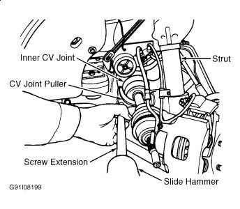

Now that is the easy part (driver's side), the hard part is removing the inner CV joint axle that is inserted to the transmission/transaxle. If you are going to use a pryer, good luck. It is very hard because the space is too tight. If you use a crow bar, you might damage the transmission housing. So, I bought an axle puller to pull out the whole axle shaft (like the item # 290138217130 from Ebay.com. Make sure it is 63 mm open rate). And pass it above the steering column.
I did not save money, I ended up paying $135 in parts and tools plus the hours I spent to remove it.
But if you bring it to an axle mechanic, they have the tools and experience to remove it.

I struggled with mine until I found the easy way-- I've done 3 so far.
When you need to get the axle stub out of the transmission, forget about prying -- It will NEVER do it. Use the power of the wedge! Get two big honking flathead screwdrivers- the ones that are 24" long with good tapers on the tips. Now get under the car and find a flat spot on the transmission between the CV joint where you can insert them. Try to put one on each side. Now start tapping on the end of the screwdriver. Alternate between sides and it won't be long before the thing pops out. Remember to do just one side at a time-- because if you pull both side out, the ring gear will drop and you won't get it back together.

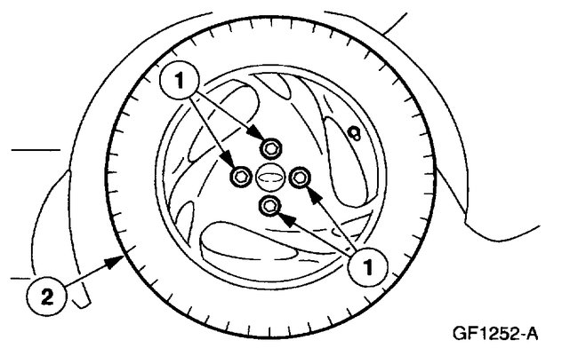

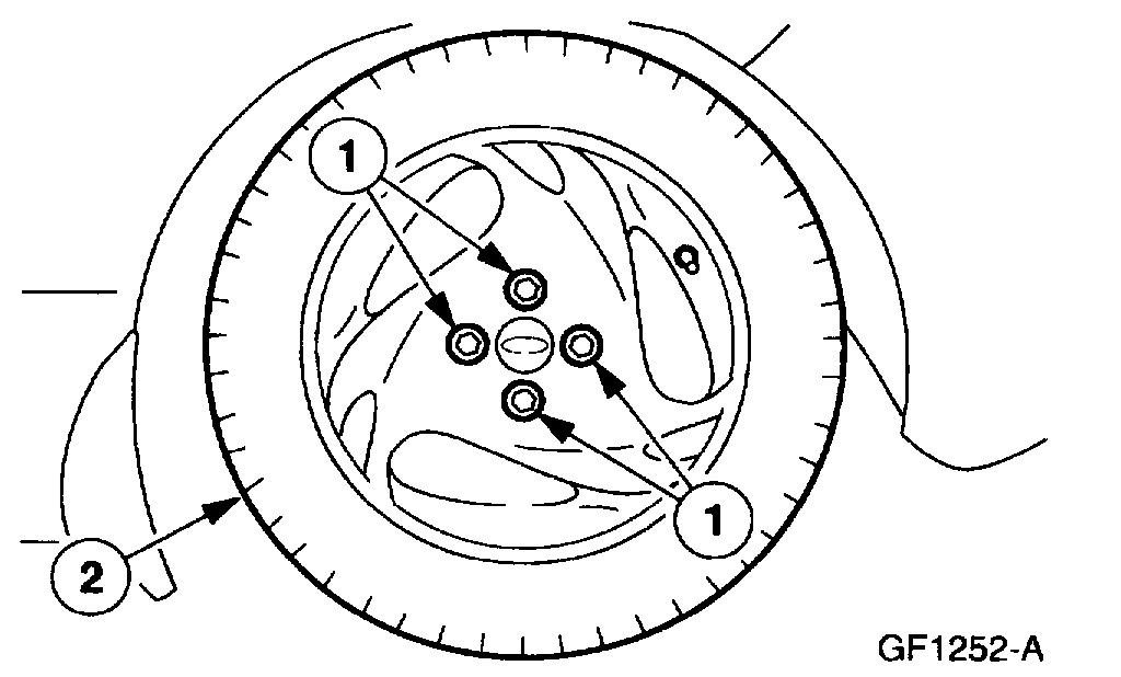

2. Remove the front tire and wheel.
1 Remove the lug nuts.
2 Remove the front tire and wheel.

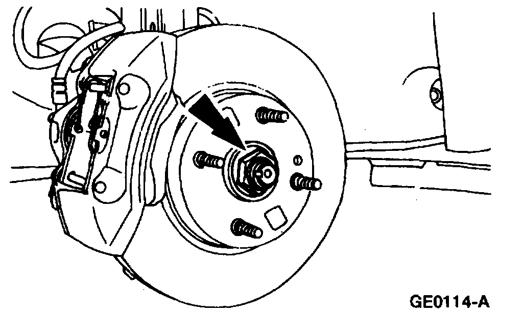

3. Raise the staked portion of the front axle wheel hub retainer using a small cape chisel.
Pic 4
4. Remove and discard the front axle wheel hub retainer.

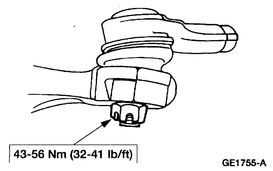

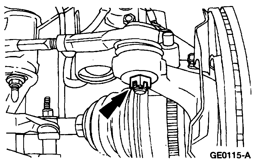

5. Remove the cotter pin and the tie rod end nut.
Pic 6

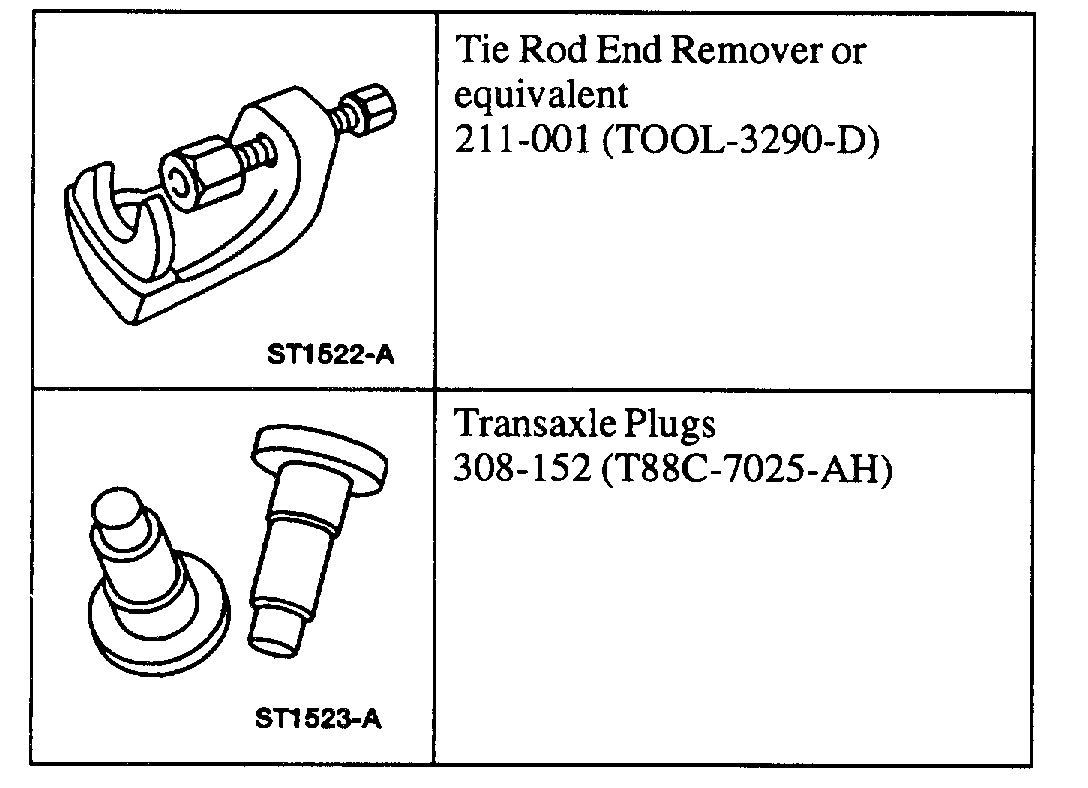

6. Use Tie Rod End Remover to separate the (A) tie rod end from the (B) front wheel knuckle.

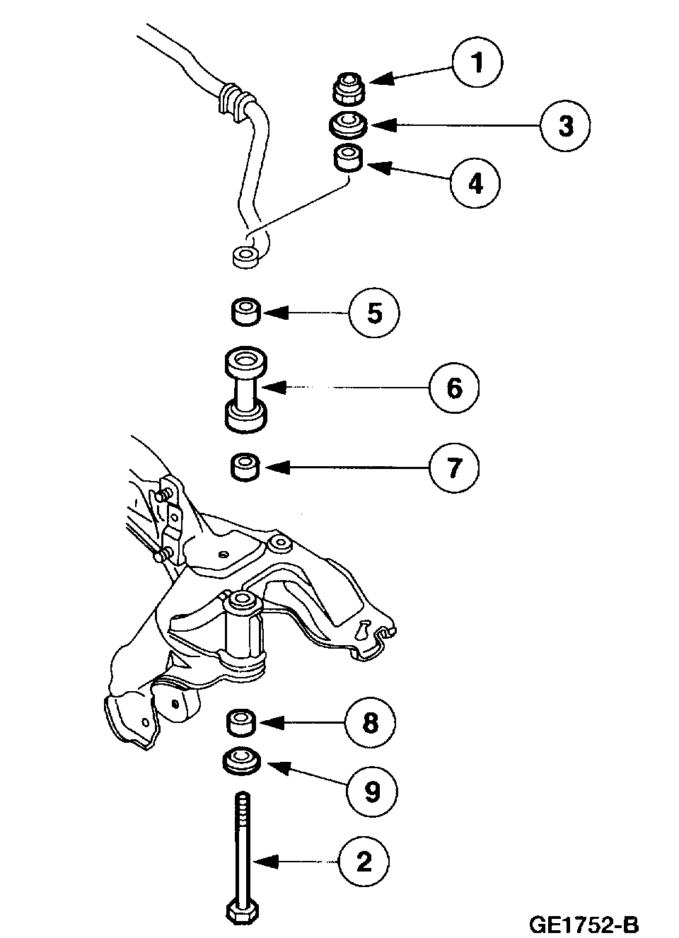

7. Remove the stabilizer bar link.
1 Remove the front stabilizer bar end nut.
2 Remove the front stabilizer bar end bolt.
3 Remove the upper front stabilizer bar end retainer.
4 Remove the front stabilizer bar end bushing above the front stabilizer bar.
5 Remove the front stabilizer bar end bushing below the front stabilizer bar.
6 Remove the front stabilizer bar end bushing.
7 Remove the front stabilizer bar end bushing above the front sub-frame.
8 Remove the front stabilizer bar end bushing below the front sub-frame.
9 Remove the lower front stabilizer bar end retainer.

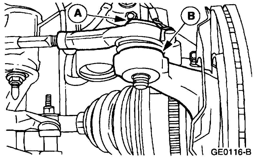

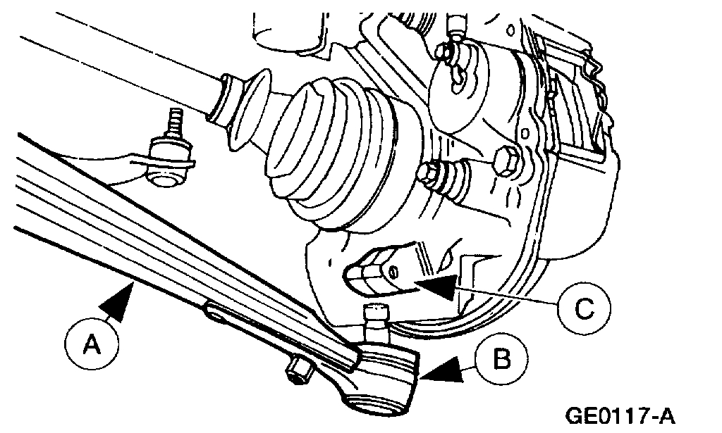

8. Remove the nut and the ball joint pinch bolt.
Pic 9
9. Pry down on the (A) front suspension lower arm separating the (B) front suspension lower arm ball joint from the (C) front wheel knuckle.
Pic 10

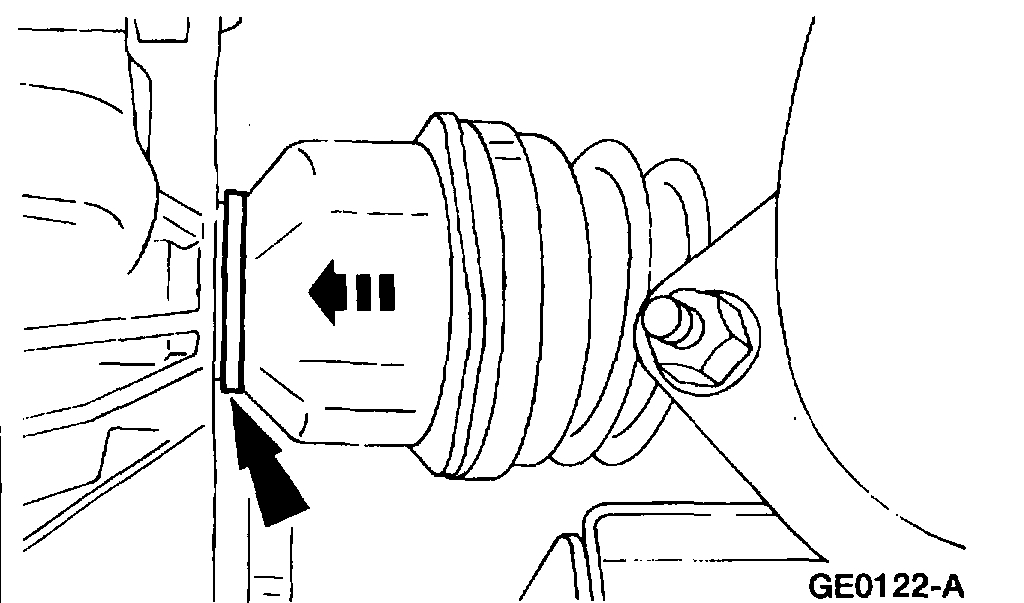

10. Pull outward on the (A) front wheel knuckle then pull the (B) front wheel driveshaft and joint from the front wheel knuckle.

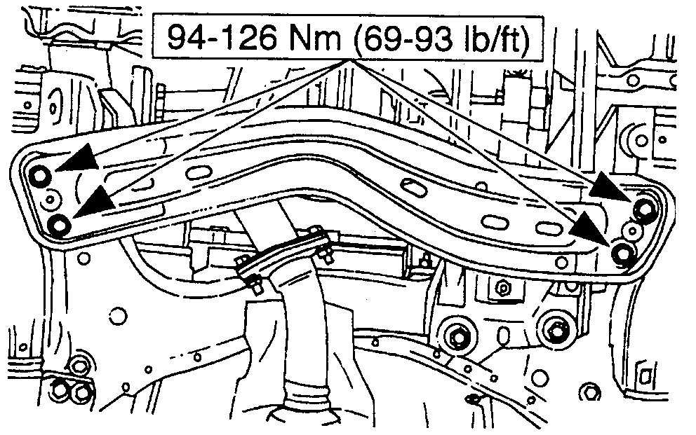

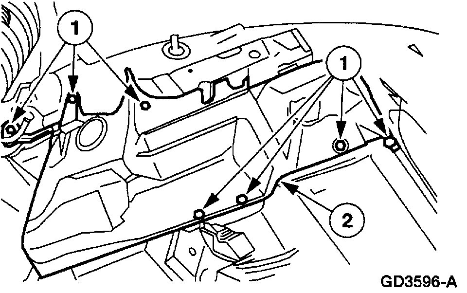

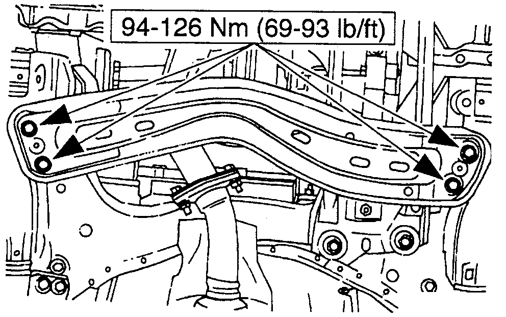

11. If removing the LH front wheel driveshaft and joint, remove the crossmember to access the front wheel driveshaft and joint.
Pic 12

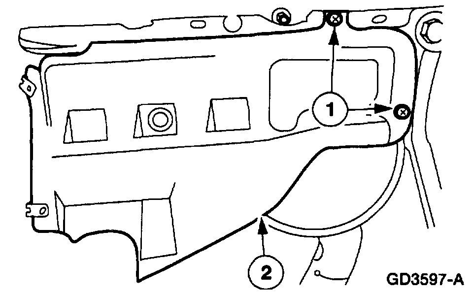

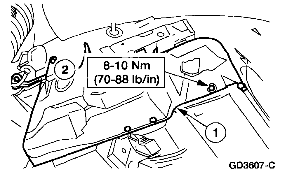

12. If removing the RH front wheel driveshaft and joint, remove the RH side shield.
1 Remove the RH side shield bolts.
2 Remove the RH side shield.
Pic 13
13. If removing the RH front wheel driveshaft and joint, remove the RH splash shield.
1 Remove the RH splash shield bolts.
2 Remove the RH splash shield.
Pic 14

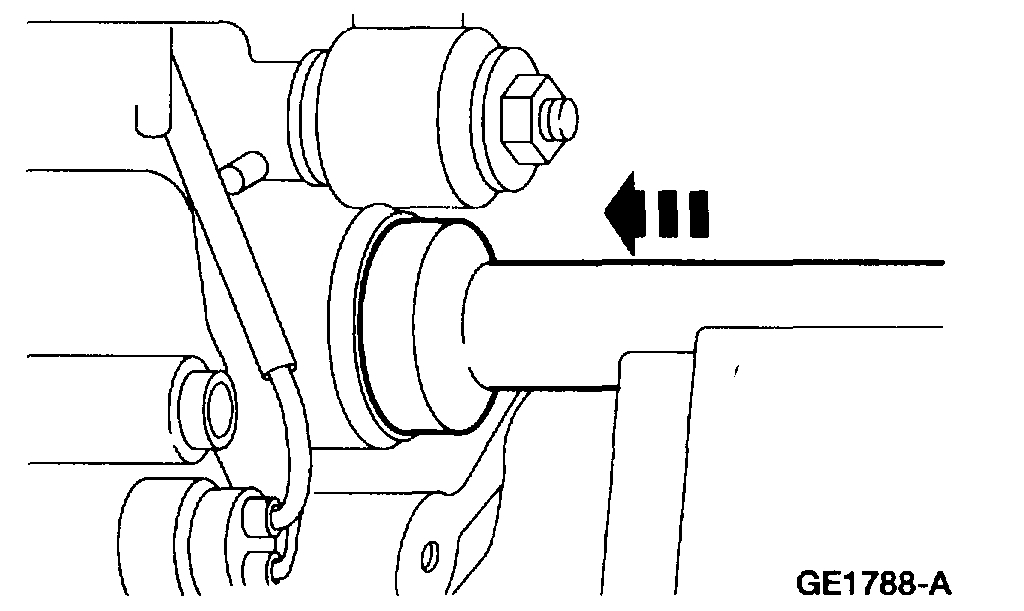

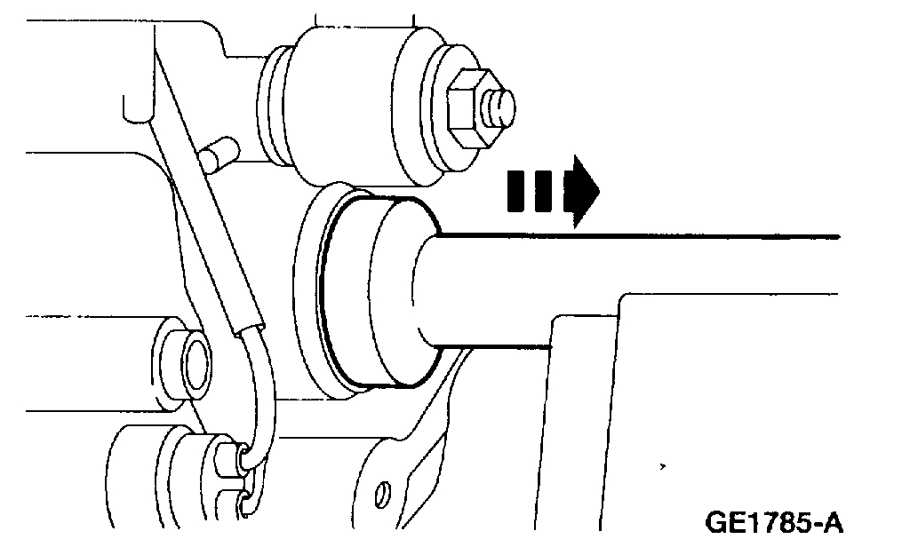

14. If removing the LH front wheel driveshaft and joint, insert a pry bar between the front wheel driveshaft and joint and the transaxle case and pry outward, releasing the front wheel driveshaft and joint from the differential side gears.
CAUTION: Extreme care must be taken to ensure that the pry bar does not damage the transaxle case, the transaxle oil seal, the front wheel driveshaft and the joint and joint boot.

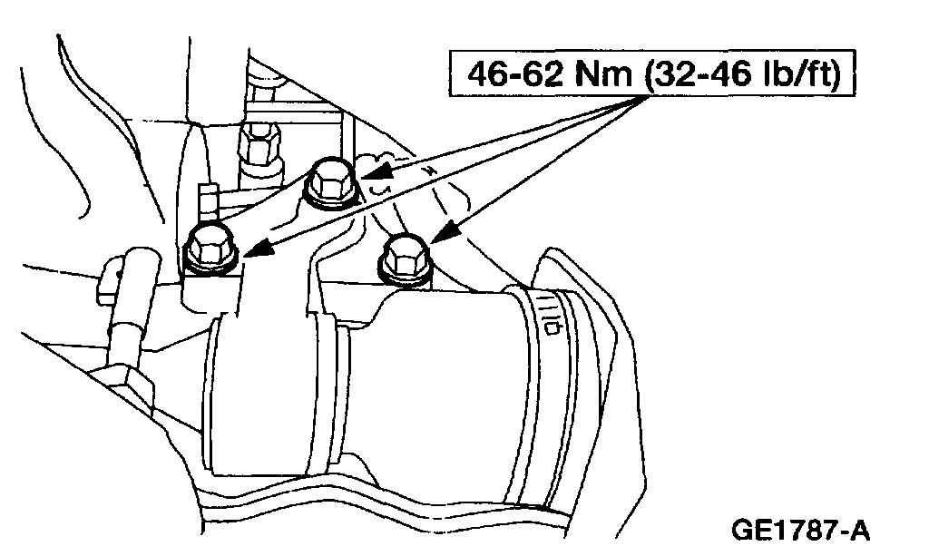

15. If removing the Coupe M/T RH front wheel driveshaft and joint, remove the bolts from the center support bearing.

18. Install Transaxle Plugs if both front wheel driveshaft and joints are removed.

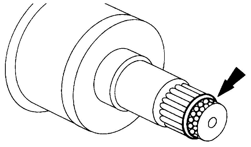

pic 19
1. If equipped, install a new driveshaft bearing retainer circlip.
Pic 20
2. Remove the transaxle plugs if necessary.
Pic 21
3. Position the front wheel driveshaft and joint so the splines line up with the differential side gear splines. Push the front wheel driveshaft and joint into the differential side gear.
NOTE: When seated properly, the driveshaft bearing retainer circlip can be felt as it snaps into the differential side gear groove.

9. Pull outward on the (A) front wheel knuckle and insert the (B) front wheel driveshaft and joint into the front wheel knuckle.

11. Position the crossmember and install the bolts.

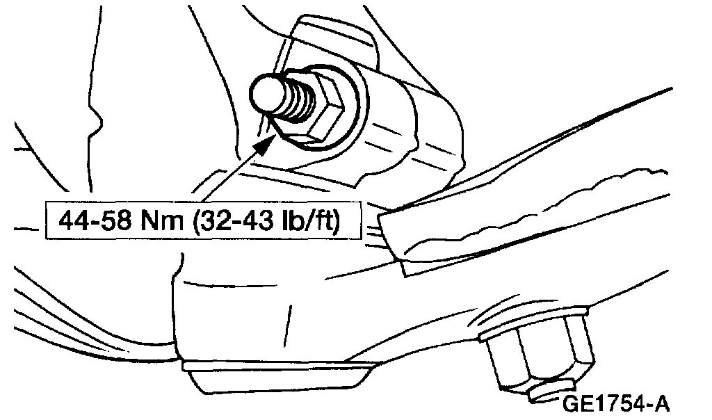

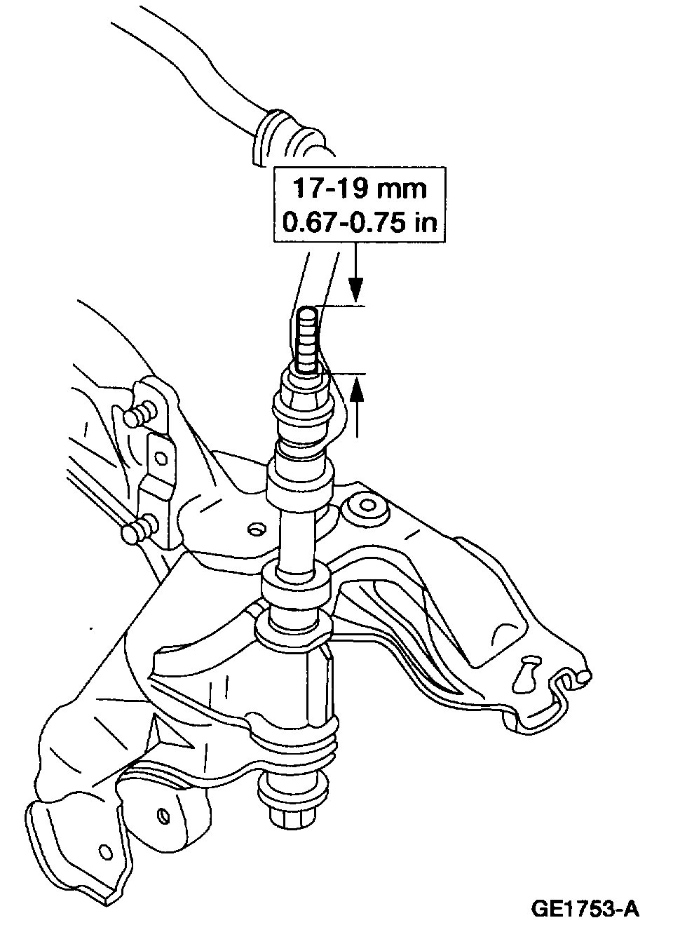

13. Install the stabilizer bar link and tighten the bar end nut to the protruding bar end bolt length specification.
Pic 32

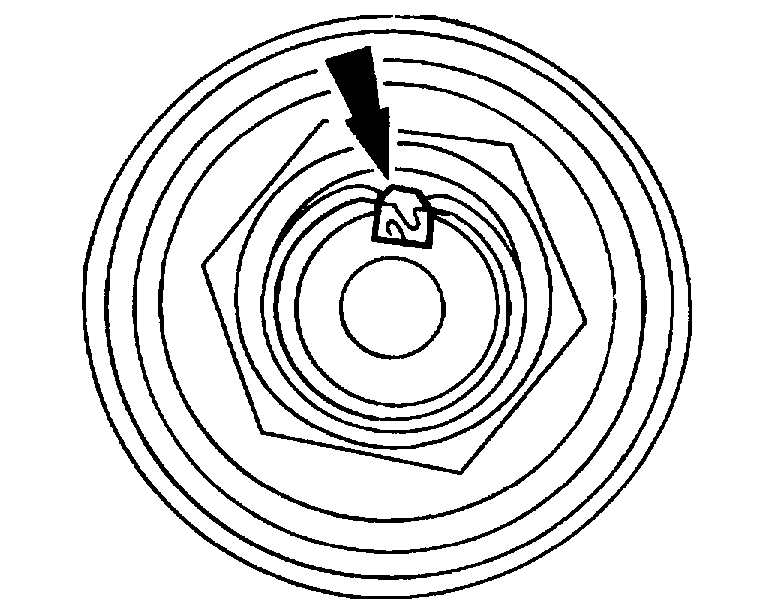

14. Position the tie rod end to the front wheel knuckle and install the tie rod end nut and a new cotter pin.
NOTE: If the slot in the nut is not aligned to the hole, tighten the nut as necessary to align.

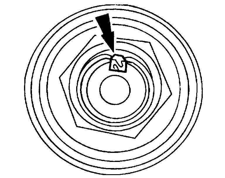

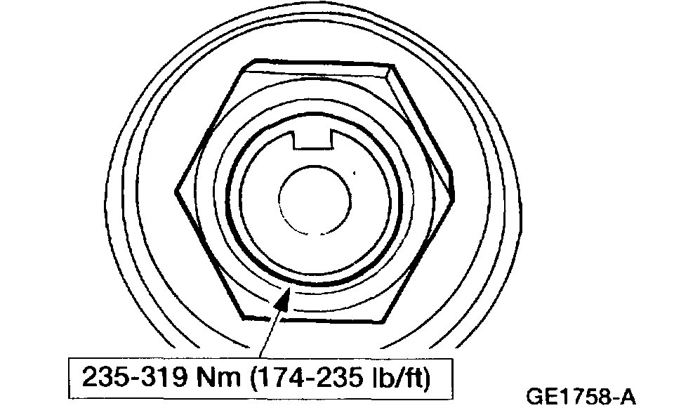

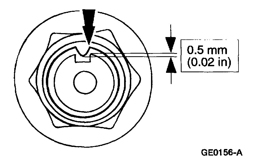

15. Install a new front axle wheel hub retainer.
Pic 34
16. Stake the front axle wheel hub retainer (the minimum specification is shown).
CAUTION: If the front axle wheel hub retainer splits or cracks after staking, replace it.

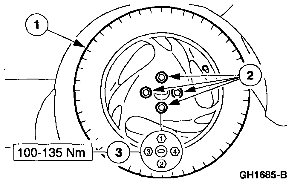

Pic 35
17. Install the front wheel and tire.
1 Install the front tire and wheel.
2 Install the lug nuts.
3 Tighten the lug nuts in sequence.

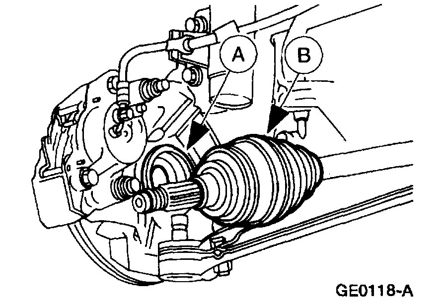

Wednesday, October 7th, 2020 AT 11:50 AM (Merged)

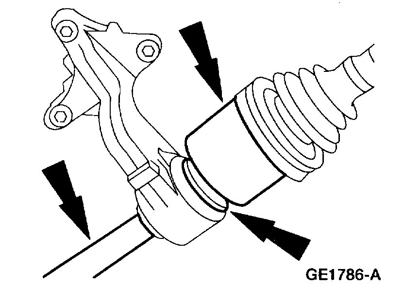

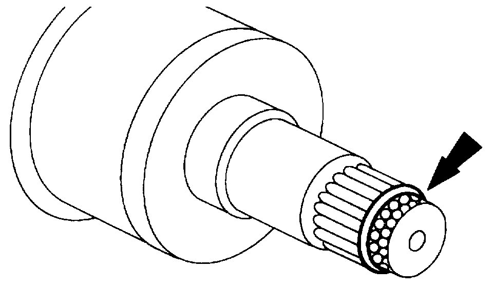

My boyfriend removed the axle from the driver side front wheel area but the drive train will not come out, how do you get it out? HELP

BMRFIXIT
  • 19,053 POSTS
https://www.2carpros.com/forum/automotive_pictures/99387_Graphic1_694.jpg

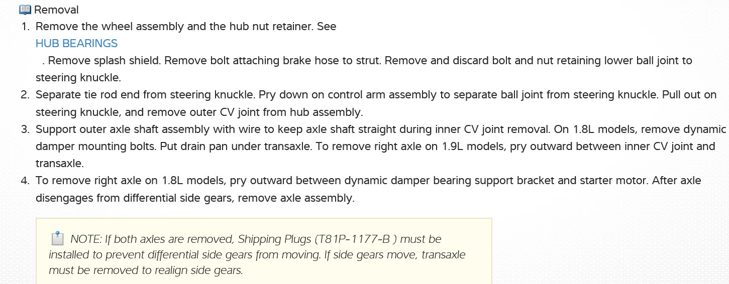

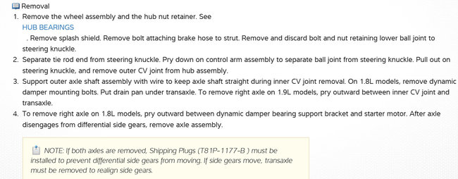

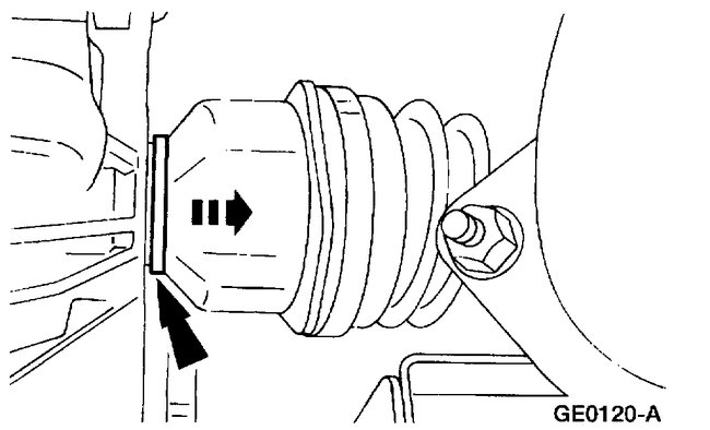

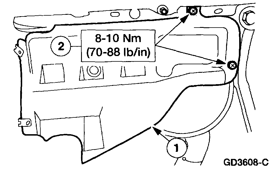

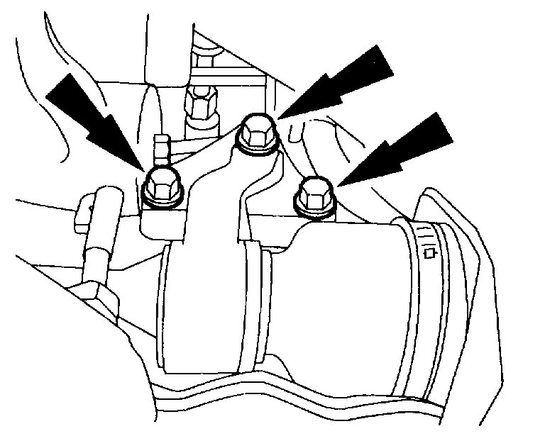

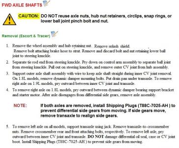

AXLE SHAFTS
CAUTION:Do not reuse wheel hub retainer nuts, circlips or snap rings.
Removal
1. Remove wheel assembly. Remove wheel hub retainer nut and discard retainer nut. Remove splash shield. Remove bolt attaching brake hose to strut. Remove pinch bolt and nut retaining lower ball joint to steering knuckle. Separate tie rod end and lower ball joint from steering knuckle. Remove stabilizer bar link. Pull downward and out on steering knuckle, and remove outer CV joint from hub assembly.
NOTE: If both axles are removed, install Shipping Plugs (T88C-7025-AH) to prevent differential side gears from moving. If side gears move, remove transaxle to realign side gears.
2. Put drain pan under transaxle. On A/T models, remove axle shaft assembly. On M/T models, remove 3 bolts retaining center support bearing for right-side axle shaft. Remove axle shaft assembly from differential side gears and then separate axle shaft from center support bearing and halfshaft.
3. On all models, remove left axle. Support transaxle using jack. Remove transaxle-to-crossmember nuts. Remove crossmember rear and front attaching bolts, respectively. Pry outward between inner CV joint and transaxle. DO NOT damage differential oil seal, case or CV boot. Install Shipping Plugs (T88C-7025-AH) to prevent side gears from moving.

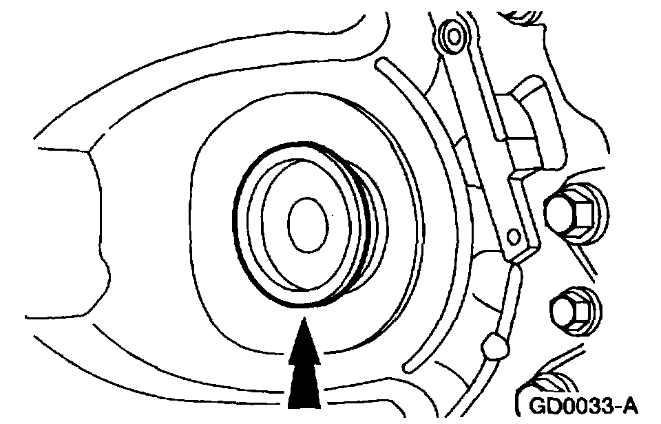

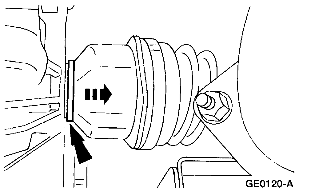

I have removed the one end of the drive shaft and have pulled out the control arm so it is no longer atached. The problem is I can not get the other end(the one in the trasmision) out. I have pulled and pryed and turned the axel, but I will not come out. I have already bought the replacement and on the new axel there is a metal ring on the end that goes into the transmision. How do I get my axel out? Is there a ring on the old one, and if so how do I remove it?
Wednesday, October 7th, 2020 AT 11:52 AM (Merged)
BLUELIGHTNIN6
  • 16,542 POSTS
https://www.2carpros.com/forum/automotive_pictures/261618_Noname_2108.jpg
https://www.2carpros.com/forum/automotive_pictures/261618_Noname2_682.jpg
