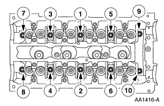

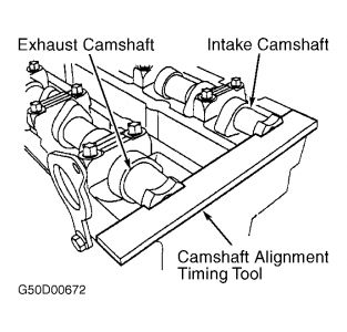

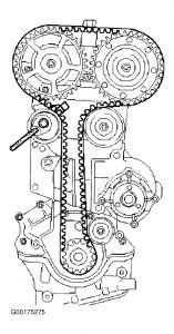

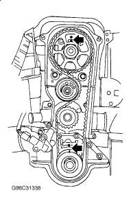

The timing went out on a friends 2002 ford escort zx2.
My husband is trying to fix it but can't find the timing marks on the cam shafts.
He has looked and looked and looked and swears that they aren't there.
They have to be there in order for it to have worked before the timing went out right?
How do we find these marks?
Nov 8, 2009 at 6:39 AM
DOCFIXIT
  • 18,828 POSTS
See diagram
https://images.2carpros.com/forum/automotive_pictures/198357_Graphic_229.jpg
Warning may have bent valves also good time to hang a water pump on it

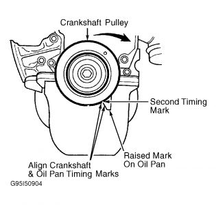

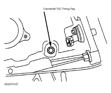

1.Disconnect negative battery cable. Remove spark plugs. Raise and support vehicle. Remove catalytic converter. Remove splash shield. Rotate crankshaft to TDC of No. 1 cylinder. Install TDC Timing Peg (T97P-6000-A) in hole at lower right of block. See Fig. 1 .
https://images.2carpros.com/forum/automotive_pictures/99387_Graphic1_50.jpg
Rotate crankshaft clockwise against timing peg. See Fig. 2 . Lower vehicle.

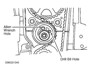

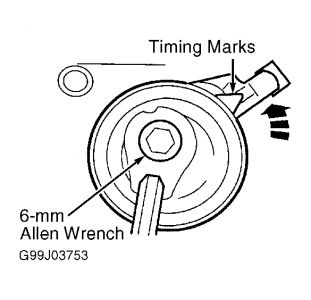

5.Loosen timing belt tensioning pulley bolt. Disconnect tensioner tab from timing cover back plate to relieve tension on timing belt. If reusing timing belt, mark direction of rotation before removal. Remove timing belt. 6.Remove camshaft alignment tool. Remove bolt and intake camshaft timing sprocket. Remove VCT oil plug, bolt and exhaust camshaft sprocket. Installation 1.Ensure crankshaft pulley timing marks are aligned. Use Camshaft Alignment Timing Tool (T94P-6256-CH) to align camshafts. Install tool in slots on camshafts at rear of engine. Ensure camshafts are aligned. Install intake timing sprocket and loosely install bolt. Rotate oil control bushing one complete turn and check for binding. Position bushing with single hole in 12 o'clock position. CAUTION: The VCT sprocket has a rectangular tab on the backside of the sprocket which must align with the hole on the front face of the thrust bushing. Failure to align may result in poor engine performance. 2.Install NEW exhaust sprocket "O" ring. Install exhaust sprocket. Ensure tab on sprocket engages hole in oil control bushing. Loosely install sprocket bolt. Loosely install timing belt tensioner. Install timing belt. See Fig. 4 .
https://images.2carpros.com/forum/automotive_pictures/99387_Graphic4_6.jpg

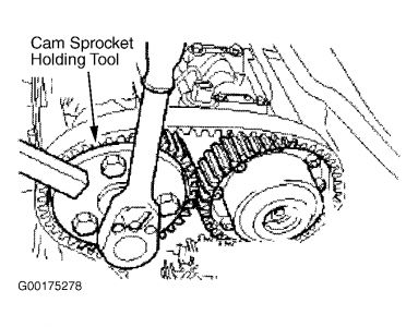

Engage timing belt tensioner tab into upper timing cover backplate. Using 6-mm Allen wrench, adjust timing belt tensioner until marks are aligned. See Fig. 5 .
https://images.2carpros.com/forum/automotive_pictures/99387_Graphic5_2.jpg
Tighten bolt to 17-20 ft. lbs. (22-28 N.m). NOTE: Camshaft must be held stationary with an open end wrench. DO NOT use alignment tool to hold camshaft in position, as damage to camshaft may occur. 3.Tighten intake camshaft sprocket bolt to 50 ft. lbs. (68 N.m). Tighten exhaust camshaft sprocket bolt to 36 ft. lbs. (50 N.m). Remove camshaft alignment tool and timing peg. Retighten exhaust camshaft sprocket bolt to 85-92 ft. lbs. (115-125 N.m). Install Variable Cam Timing (VCT) oil plug, if necessary. 4.Ensure second crankshaft timing mark is aligned with raised mark on oil pan. Position crankshaft just prior to TDC. Install TDC timing peg. Rotate crankshaft clockwise against peg. Ensure camshafts are aligned. If crankshaft and camshaft are misaligned, repeat procedure until alignment is correct. 5.When alignment is correct, complete installation by reversing removal procedure. When installing valve cover, clean gasket mating surfaces before installing NEW gasket. Install and tighten valve cover bolts in a diagonal pattern starting from the inside working outward. Tighten all nuts and bolts to specification.

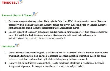

DAVE H
  • 13,384 POSTS

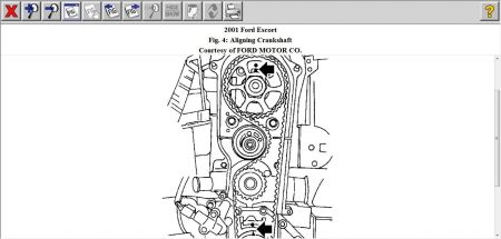

Removal (Escort & Tracer) Disconnect negative battery cable. Place cylinder No. 1 to TDC of compression stroke. Remove accessory drive belt and tensioner. Remove timing belt cover. Raise and support vehicle. Remove right hand splash shield. Remove crankshaft pulley. Align timing marks. See Fig. 1. Loosen timing belt tensioner. Using an 8-mm hex wrench, turn tensioner 1/4 turn counterclockwise. Insert 1/8 drill bit to lock tensioner in place. See Fig. 2. If reusing old belt, mark belt with arrow to indicate original direction of rotation. Remove timing belt. Fig. 1: Aligning Crankshaft & Camshaft Timing Marks Courtesy of FORD MOTOR CO. Removal (Escort & Tracer) Disconnect negative battery cable. Place cylinder No. 1 to TDC of compression stroke. Remove accessory drive belt and tensioner. Remove timing belt cover. Raise and support vehicle. Remove right hand splash shield. Remove crankshaft pulley. Align timing marks. See Fig. 1. Loosen timing belt tensioner. Using an 8-mm hex wrench, turn tensioner 1/4 turn counterclockwise. Insert 1/8 drill bit to lock tensioner in place. See Fig. 2. If reusing old belt, mark belt with arrow to indicate original direction of rotation. Remove timing belt. Fig. 1: Aligning Crankshaft & Camshaft Timing Marks Courtesy of FORD MOTOR CO. Fig. 2: Identifying Timing Belt Tensioner Courtesy of FORD MOTOR CO. Installation Ensure timing marks are still aligned. Install timing belt in a counterclockwise direction starting at the crankshaft. If reusing old belt, ensure it is installed in original direction of rotation. Keep belt span between crankshaft and camshaft tight while installing timing belt over camshaft. Remove drill bit and tighten tensioner bolt. Rotate crankshaft clockwise 2 revolutions. Recheck timing mark alignment. To complete installation, reverse removal procedure.
https://images.2carpros.com/forum/automotive_pictures/266999_cam_1.jpg
https://images.2carpros.com/forum/automotive_pictures/266999_cam2_2.jpg

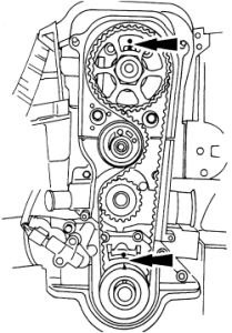

VARELITA
timing mark for a ford escort 2.0l
Sep 28, 2020 at 3:39 AM (Merged)
  • 75,992 POSTS
https://images.2carpros.com/forum/automotive_pictures/12900_t1_17.jpg

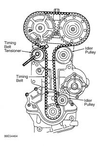

JAZZERGAL503
  • 6 POSTS
Where can I find the total procedure to remove and install the timing belt for 2000 Ford Escort?
Sep 28, 2020 at 3:40 AM (Merged)
BLUELIGHTNIN6
  • 16,542 POSTS
https://images.2carpros.com/forum/automotive_pictures/261618_Noname_1887.jpg
https://images.2carpros.com/forum/automotive_pictures/261618_Graphic_386.jpg
https://images.2carpros.com/forum/automotive_pictures/261618_Graphic2_55.jpg

1.Remove or disconnect the following:
Negative battery cable
Spark plugs
Catalytic converter
Right front wheel
Right inner splash shield
Accessory drive belt and idler pulley

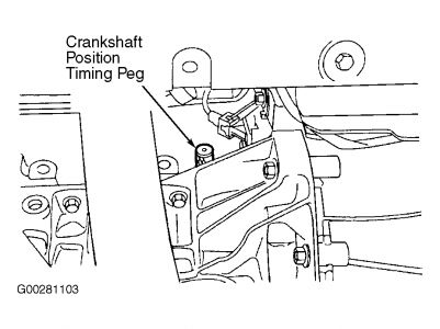

2.Rotate the crankshaft to Top Dead Center (TDC) and install Crankshaft TDC Timing Peg T97P-6000-A.
3.Rotate the crankshaft clockwise against the peg.
4.Remove or disconnect the following:
Water pump pulley
Valve cover
Crankshaft pulley
Timing belt covers
5.Install Camshaft Alignment Timing Tool T94P-6256-CH into the slots of both camshafts at the rear of the cylinder head to lock the camshafts into position.
6.Loosen the timing belt tensioner bolt and relieve the tension on the timing belt by disconnecting the tensioner tab from the timing cover back plate.
7.Remove the timing belt.
To install:
1.Install the timing belt.
2.Engage the timing belt tensioner tab into the timing cover back plate.
3.Adjust the timing belt tensioner until the index marks are aligned. Tighten the tensioner bolt to 17-20 ft. lbs. (22-28 Nm).
4.Remove the camshaft alignment tool and the crankshaft TDC peg.

Timing belt covers
Crankshaft pulley. Tighten the bolt to 81-89 ft. lbs. (110-120 Nm).
Valve cover
Water pump pulley
Right front wheel
Catalytic converter
Spark plugs
6.Start the engine and check for proper operation.
