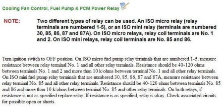

where is the fuel pump relay located and how can you test it ?

https://images.2carpros.com/forum/automotive_pictures/261618_Noname_854.jpg
