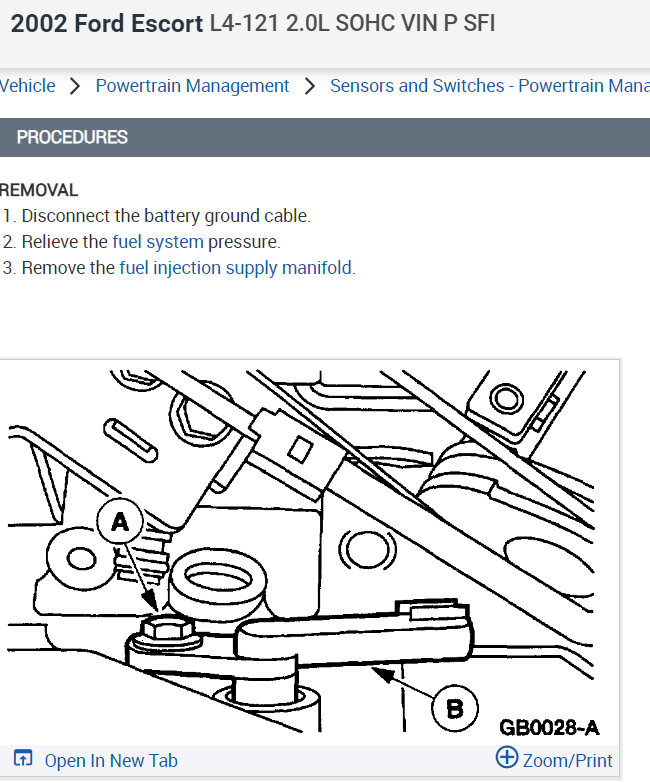

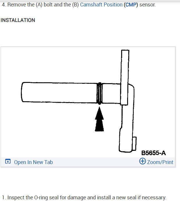

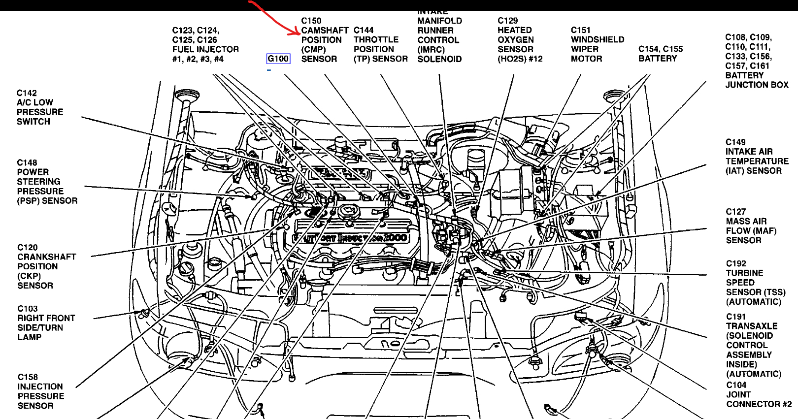

They ran the codes for the camshaft position sensor which is a common failure. Here is the location so you can swap it out. Clear the codes when completed. Check out the images (below). Let us know how it goes
