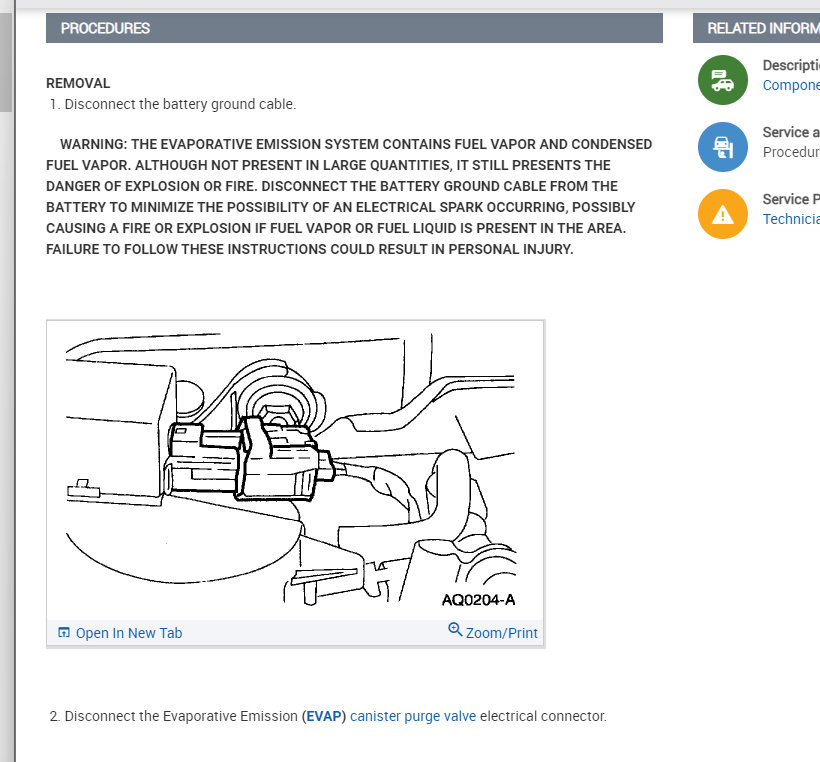

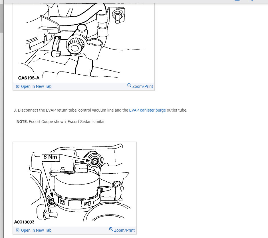

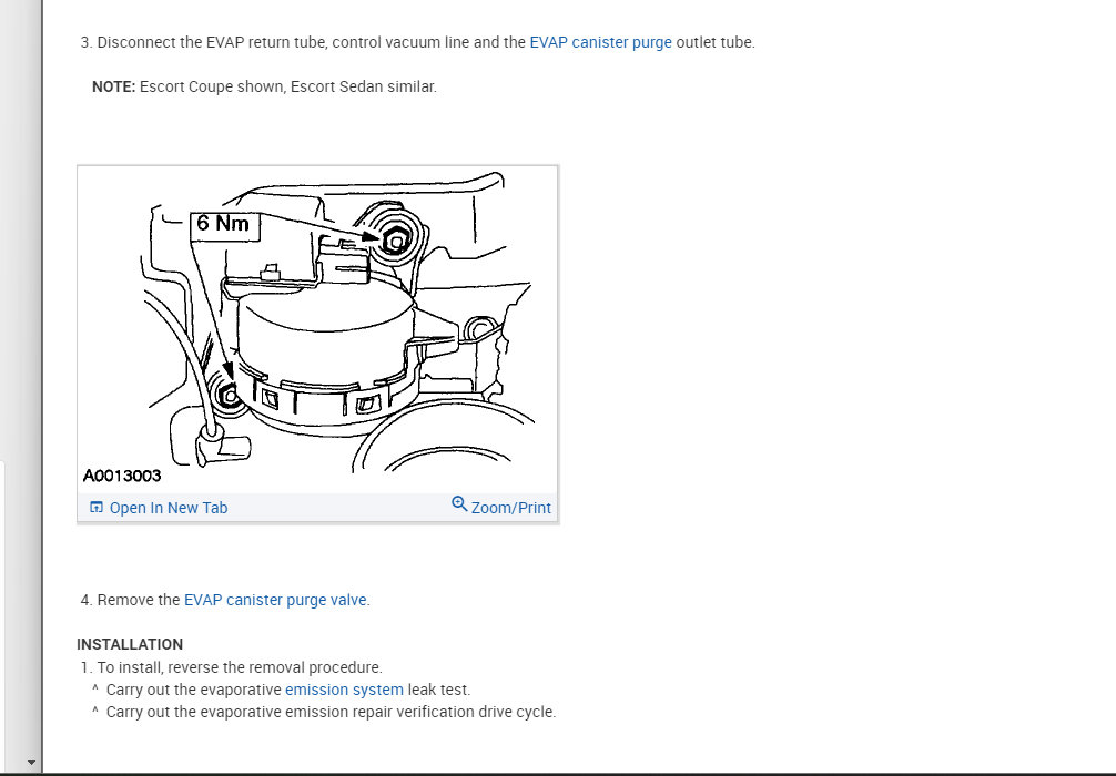

Thanks for providing that info. Unfortunately, this is a post from well over 10 years ago, so they are unlikely going to benefit from it.
However, I am sure others will.
One thing I will add to this is due to the fuel level having an effect on issue that was mentioned in the second post then this means it is likely related to the EVAP system.
Basically, when the purge hangs open the engine gets flooded and if the fuel tank is full or low then that will affect the vapor volume.
https://www.2carpros.com/articles/symptoms-of-low-engine-power
I would suggest removing the purge and check to see if it is stuck.
I am attaching the info below on this so hopefully this will help others in the future.
Thanks
