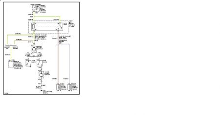

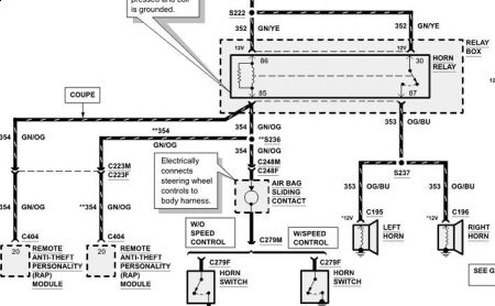

The car horn, which the switch is located in the air bag, starts to beep constantly at random times (the last time was at 10:00 PM one evening) which caused me to pull the fuse and go without a horn. I've been advised that with the switch being in the air bag it's going to cost a minimum of $800.00 to fix. My other option is to run a kill switch to one of the terminals of the horn so I can deactivate it when not driving the car but I can't find the horn under the hood. What is the best solution that won't break the bank and where do I find the actual horn if the kill switch idea is a good one?

Hello, in my personal opinion,I 'd take it to a qualified technician and get it fixed.
In the past, where ground side of the coil for the horn relay, only affected the horn, I have used a switch in that circuit, but, not with this system. Others may have a different idea.

OK, now I understand. I'll attach a simple diagram of the horn circuit. With a little "creative wiring", you could attach the feed to the horn curcuit to one that is hot only with KEY ON.

Thanks but anyway to make the picture bigger? By the time I blow it up it's too distorted to make anything out. I don't suppose it comes with written instructions.
Friday, April 3rd, 2009 AT 1:53 PM
JAMES W.
  • 2,394 POSTS
I'm having trouble with my posting image program, but jdl123 posted a diagram earlier that is basically the same, and no, there aren't any "written" instructions for what you're trying to do. You're treading new ground.
