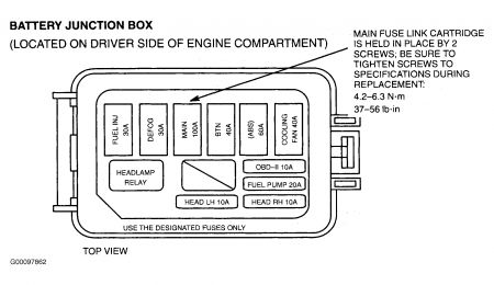

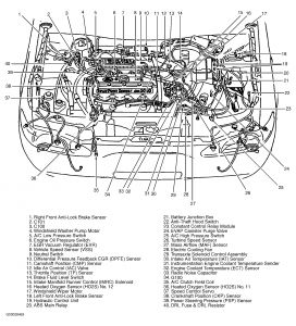

odometer has stopped speedometer still works. This is my daughters car she lives 3 hours away. I would like to bring every thing I might need there when we go to see her in a few weeks. is this usually a whole unit replace or is it a gear or cable replace.( Note we just installed a new motor 2000 miles ago it just quit now ) I pulled engine and transmission I know I need to check if something came unhooked. Thanks in advance

the speedometer/odometer is controoled the VSS (vehicle speed sensor) check OBD fuse in battery fuse box under hood ..
https://images.2carpros.com/forum/automotive_pictures/266999_fuse_7.jpg
if fuse ok check wiring coneections to sensor or replace sensor ..
https://images.2carpros.com/forum/automotive_pictures/266999_ford_1.jpg
Vehicle Speed Sensor (VSS)...On lower rear of transaxle. See Fig. 2
