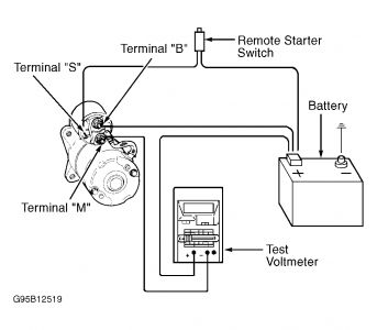

Hi thanks for looking at my q. First my car would not go into drive from park so figure soleniod so quick fix popped the top off on the automatic shifter stuck something in to get in to unlock, starts fine ran fine. Was out stopsed the car would not start ,,,gah, so had it towed home. Can i just replace the solenoid and will it work again or has it wrecked something else now since i didn't replace it right away? It just clicks when i turn it on and all else lights up. If i can where is the solenoid i have an idea and have seen videos , but looks alot different looks like its all attached to the starter motor or am i looking at something different? If it is attached do i take it all off to replace it? Appreciate it alot thanks!

Yes thank you have done all that stuff. Was told i have to go under the car to get at the starter solenoid so it's jacked up and need a diagram of where it is located ....please

https://images.2carpros.com/forum/automotive_pictures/99387_Graphic1_200.jpg
Disconnect negative battery cable. Remove air cleaner outlet tube. Remove top 2 starter bolts. Raise vehicle on hoist. Remove solenoid wiring protective cap. Disconnect wiring from starter solenoid. Remove lower starter bolt. Remove starter. To install, reverse removal procedure.
