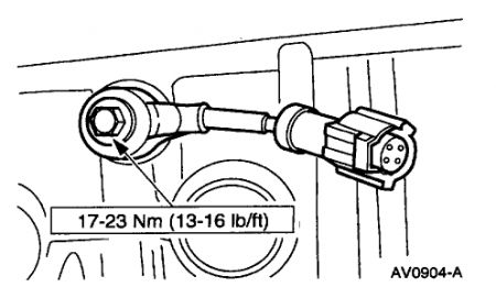

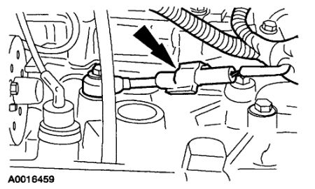

WHERE IS THE KNOCK SENSOR LOCATED.
Sep 11, 2010 at 2:51 AM
Experienced Mechanic
75,988 POSTS
Hi eloymunoz,Welcome to 2carpros and TY for the donation. The Knock Sensor (KS) is located on the RH side of the cylinder block.
