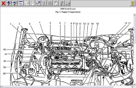

ok I checked with autozone and they ran some codes for me and told me my IAC was bad the next time we went out for a look, just short of removing the throttlebody we could not find this component and on top of that they want almost 100 dollars for it when they cant locate it any idea where its at?
If you email me back I will be more that happy to send some pictures of the engine
Dec 26, 2007 at 3:28 PM
  • 75,992 POSTS
The IACV Its on the top left rear of engine see item #13 below

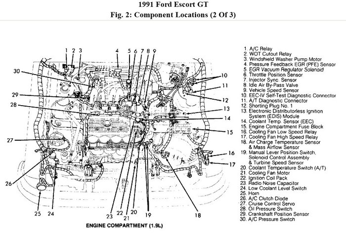

The Ford tem for it is , "Idle Air By-Pass Valve". It is in location number 8 on this diagram.

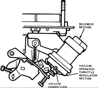

First, your car doesn't have a carb. It's fuel injected. It doesn't use an Idle Air control. This one uses and electronic speed control motor.

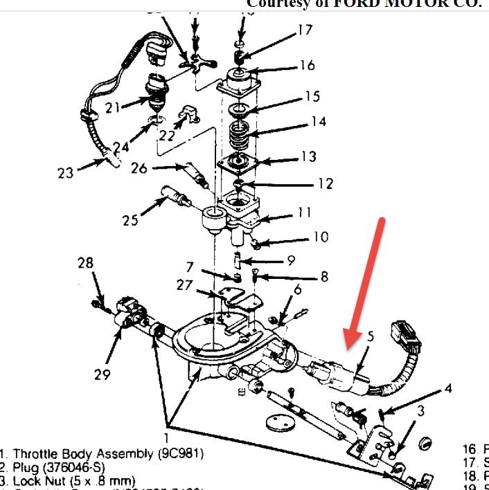

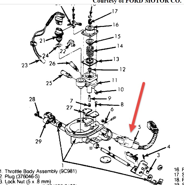

My 1988 Ford Escort is having idle issues. However I cannot find an IAC valve anywhere near the fuel injector/air intake.
Does the 1988 Ford Escort 1.9 liter engine have an IAC valve?
Thanks
Joe Mendes
Jan 6, 2020 at 7:23 AM (Merged)
HMAC300
  • 48,601 POSTS
if this is what you have in pic then item 5 is iac

I did remove that part and wiped it down, it did not appear to be an IAC valve but more like an actuator (like an small electronic piston) that physically pushes on the throttle when it receives electronic signals to do so.
One thing I noticed is that it moves slowly, do you know if it can be lubricated, can I try to oil it? Or is that a bad idea?
Once again, Thank you very much.
HMAC300
  • 48,601 POSTS
it doesn't push on the throttle it allows air in and it's supposed to work slow. no need to oil I ttry cleaning with choke cleaner spraying into the hole. then scan for codes and check fuel pressure with a gauge. autoparts rent it.
