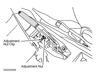

Can anyone tell me how to adjust the emergency brake. It does not hold tight when appied.

1st check rear brakes and adjust as needed hand brake adjustment goes like this >
https://images.2carpros.com/forum/automotive_pictures/99387_escorr_1.jpg
