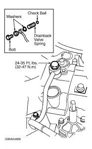

I took my car into mr lube to serivce the transmission and they hooked up hoses t the transmission and tried to flush ou the old stuff and install new fluid, they told me the pump would suck up the new fluid but would not discharge any from the transmission. So what happened is they basically added 5 litres to my transmission and could not get any to come out. They had to suck it out down to the proper level. The fellow at ford said there is a one way valve that may be stuck. Is this accessible to a person that is pretty mechanically inclinded or does it have to got to a transmission shop? I could not find any information where this one way valve would be? Any help would be great

I have all of the oil and pan removed and cleaned, ready to install, but I have the hose at the top of the transmission removed and pulled out a spring that is in the hole at the top of the transmission. I know can see a steel ball bearing down the hole. It seems to be stuck in there and can't get it out. There is dirt or corrosion around the bearing and it seems stuck in the hole. I belive it is stuck in there and not allowing fluid to travel up out of the transmission, causing the problem I stated above. Do you know if there is a way to remove or get at this ball bearing without removing the transmission and taking it to a transmission shop?

Sorry about the confusion .. the checkball just drop's in there .. it SHOULD come out freely .. try a magnetic stick .. you can get these from any autoparts store .. if you have tried this and it is absolutely jammed solid .. the only other way i can think of is to try and clean around it with a needle to try and free it off .. i'm afraid the only other way to get it out is stripping the box .. i don't have any removal procedure or tips in my manual ... obviously this part removal is regarded as an easy job . MOST TIMES... you seem to be the unlucky one ??
https://www.2carpros.com/forum/automotive_pictures/266999_drain_1.jpg

much appriciated, that is what I thought, it should come out easy, but no luck, I will try cleaning around it with a metal dental pick and see if I cant free it up.
Where did you get the image of that? Is that a website or from a book, is it accessable to the public?

No problem. The pic's and info are from. Website. You need to subscribe.
