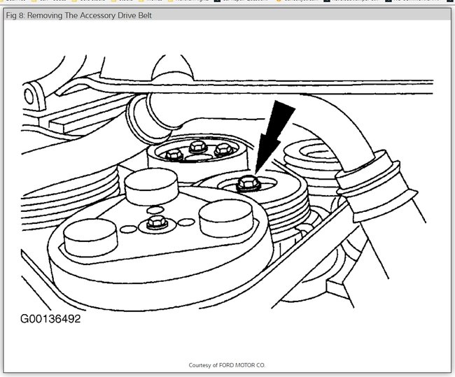

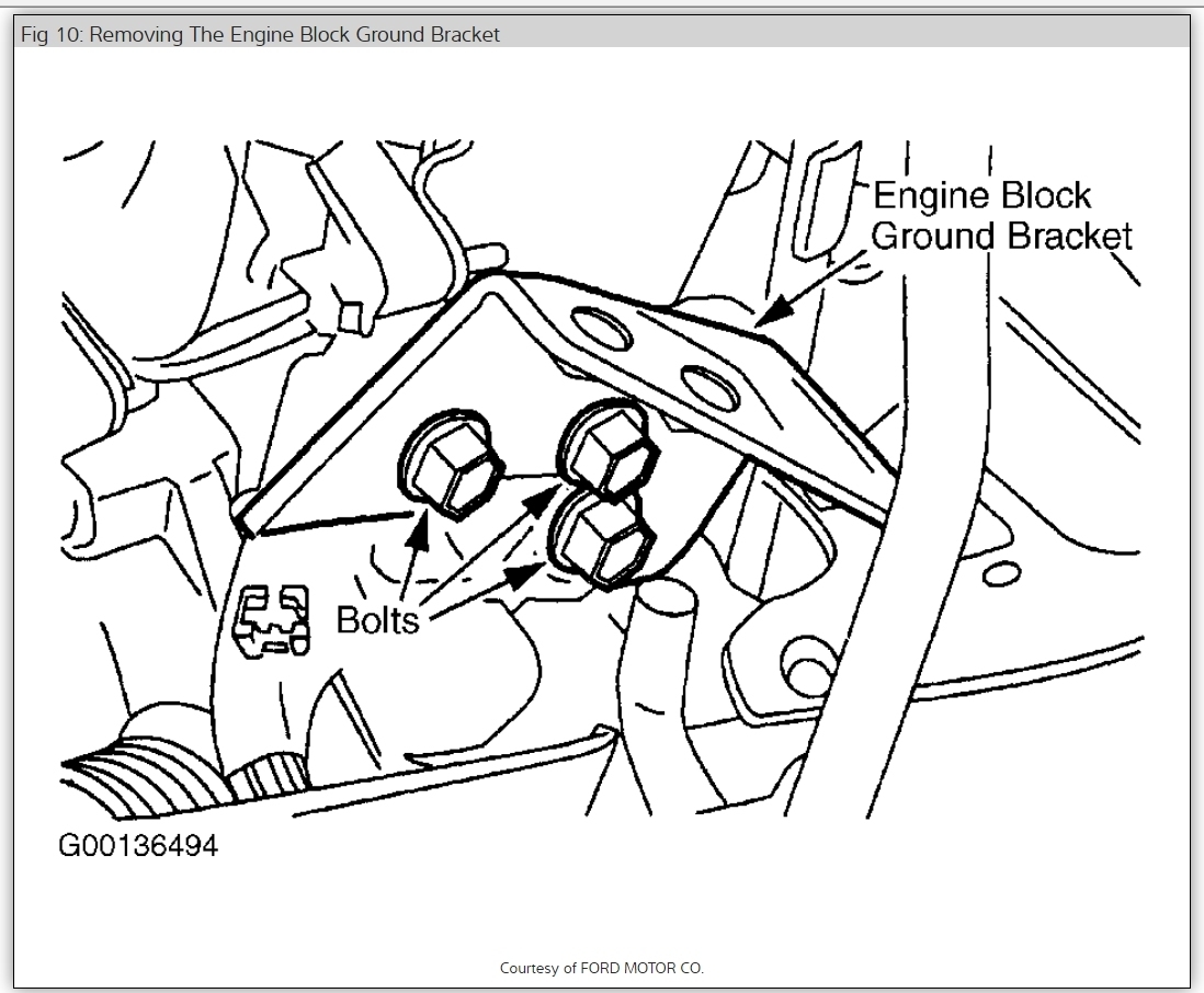

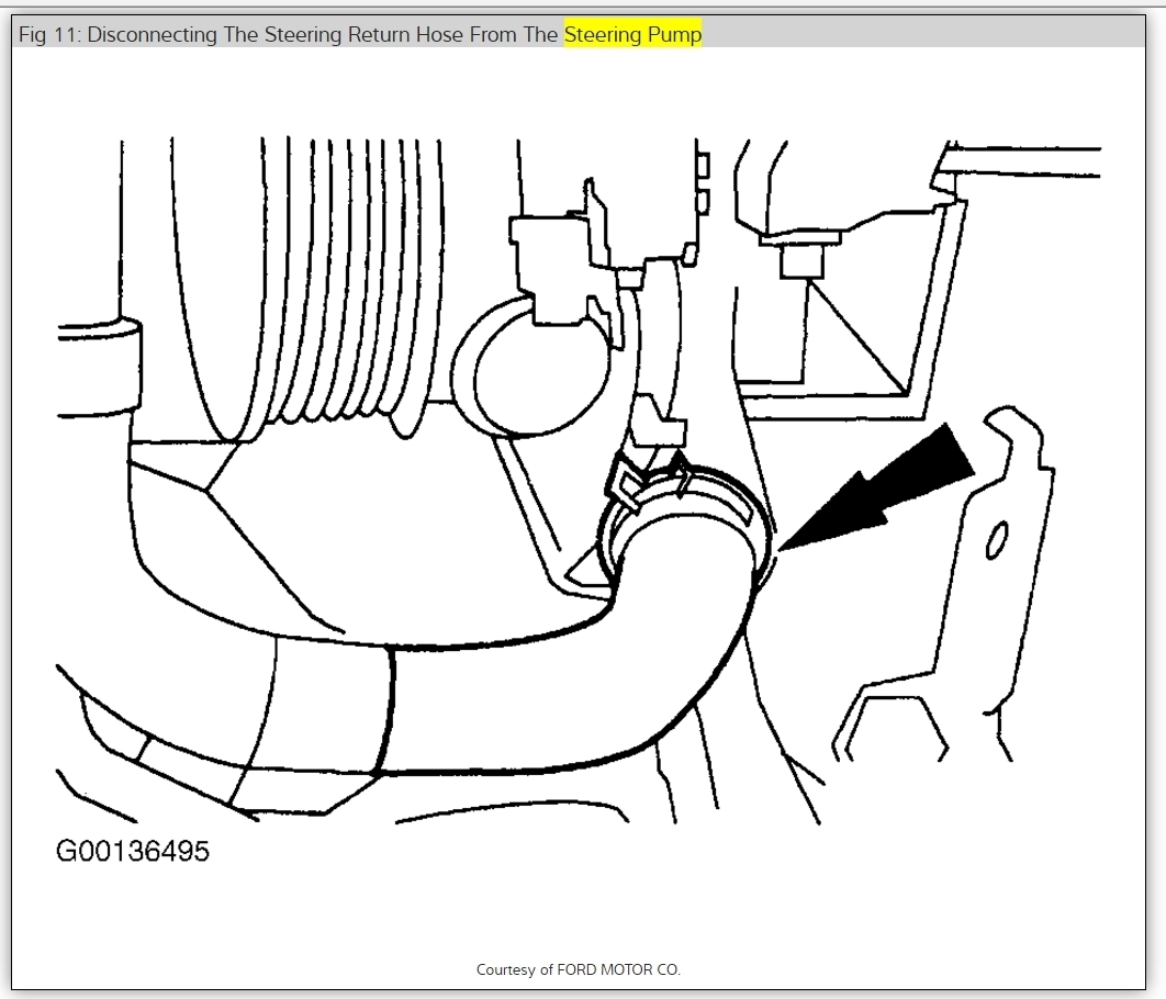

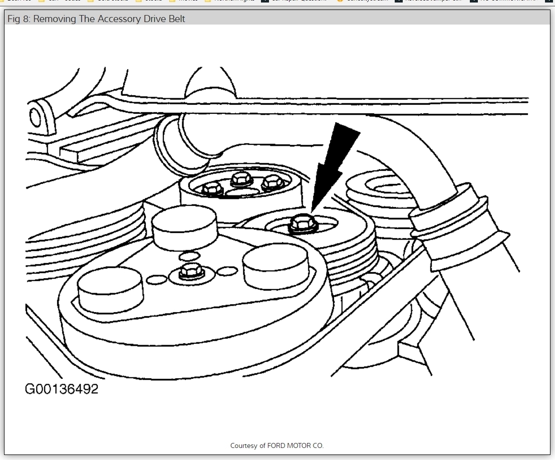

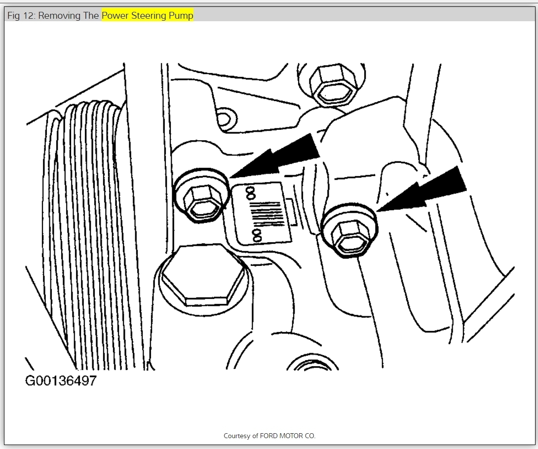

How do I remove Power Steering pump?
Feb 14, 2009 at 9:04 AM
  • 54,845 POSTS
Here is a guide that will show you what you are in for with diagrams for your car below.
https://www.2carpros.com/articles/how-to-replace-a-power-steering-pump
and
https://youtu.be/MtHG4y_rdMI
