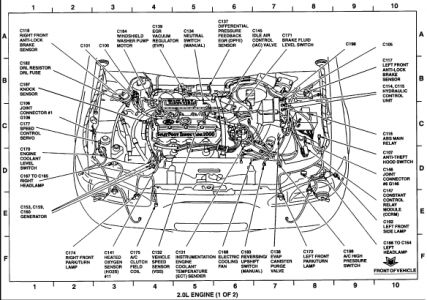

1999 Ford Escort I bought a new speed sensor
94,000 MILES • 4 CYL • FWD • AUTOMATIC
RON VALIC
howdy dudes, I just want to know where is the speed sensor located. it looks like a piece of cake to install, so can you tell me if it is . thankyou for your time and answer.
Mar 20, 2010 at 12:24 PM
BMRFIXIT
  • 19,053 POSTS
Turbine Speed Sensor (A/T) LOCATED On left side of engine, on top of transaxle.
Vehicle Speed Sensor (VSS) LOCATED On lower rear of transaxle
Mar 20, 2010 at 12:53 PM
  • 75,988 POSTS
https://images.2carpros.com/forum/automotive_pictures/12900_vss_24.jpg
Removal 1.Raise and support the vehicle. 2.Disconnect the Vehicle Speed Sensor (VSS) electrical connector. 3.Unclip the Heated Oxygen Sensor (HO2S) wire clip from the VSS bracket. 4.Remove the VSS. 5.Remove the bolt. 6.Remove the VSS. Installation 1.To install, reverse the removal procedure. https://www.2carpros.com/kpages/auto_repair_manuals_alldata.htm
