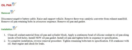

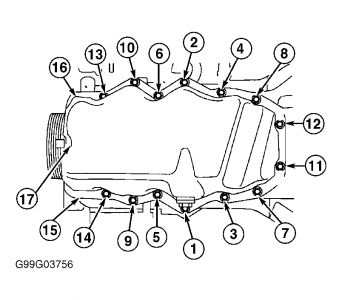

how do i remove the oil pan? The car is an 1999 escort zx2 with a 2.0l engine. i have tried repairing the hole with jb weld with no luck and so want to replace oil pan.

https://images.2carpros.com/forum/automotive_pictures/261618_Noname_2517.jpg
https://images.2carpros.com/forum/automotive_pictures/261618_Graphic_622.jpg
