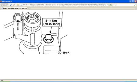

How do I take out the vss on a 98 Ford Escort zx2?
Tuesday, October 19th, 2010 AT 12:37 PM
SATURNTECH9
MECHANIC
30,869 POSTS
REMOVAL
1. Disconnect the Vehicle Speed Sensor (VSS) electrical connector.
2. Remove the bolt and the VSS.
The Vehicle Speed Sensor is located at the lower rear of the transaxle.
