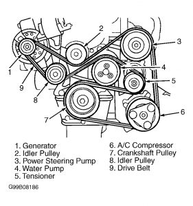

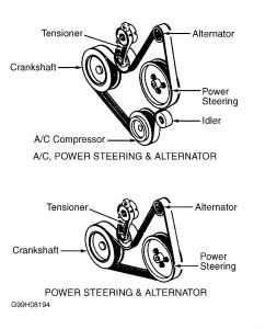

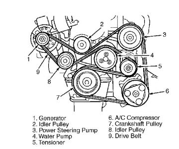

1998 Ford Escort locating tension pulley and serpentine bel
1998 FORD ESCORT
STEVENGLASCOJR
1998 Ford Escort 4 cyl Automatic
Please help me to locate the serpentine belt tensioner (diagram would be helpful).
I also need a diagram on serpentine belt replacement for this vehicle.
1998 Ford Escort Sport Coupe w/ AC and Power Steering. Dual overhead Cam.
Engine is a 16v Zetec VCI.
PLease help!!!!!!!!

https://images.2carpros.com/forum/automotive_pictures/30961_zx2_1.jpg

https://images.2carpros.com/forum/automotive_pictures/99387_escort_belt_2.jpg
https://images.2carpros.com/forum/automotive_pictures/99387_escort_belt_3.jpg
