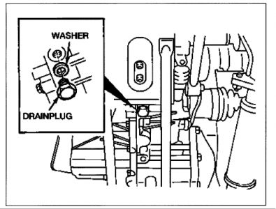

I cannot find the filler plug for my manual transmission on my car. Where is it, and do you have any pictures?

The manual trans-axle has a drain plug located between the two support bars that run from front to back underneath the unit. However, removal of the speed sensor is required. There is an electrical connector that must be disconnected. The retainer clip for the speedometer cable must be removed along with the speedometer cable. Pry the speed sensor from the trans-axle. Use the end of the speed sensor to check the level of the fluid. Here are diagrams below to help you see what I am talking about.

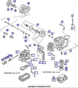

IMPALASS
  • 3,112 POSTS
Hello.
I have attached a picture item number 2 is the dip stick. This is where you check and service.
https://www.2carpros.com/forum/automotive_pictures/248015_Tran_Dip_stick_1.jpg
Wednesday, August 29th, 2018 AT 3:24 PM (Merged)
SKEET06
Cannot hardly see picture, but on the bottom it reads automatic transmission mine is a five speed manual.
+3

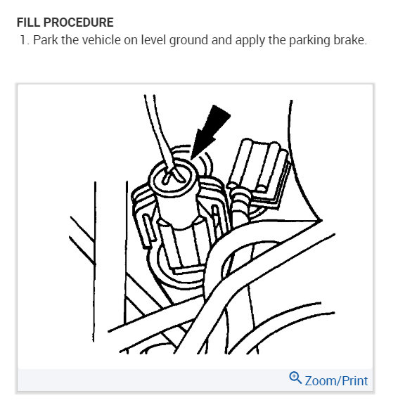

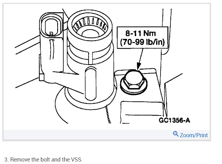

Transmission Fluid Check
The transmission fluid level should be checked only with the vehicle parked on level ground.
Be sure the vehicle is on level ground and apply the parking brake.
Disconnect the electrical connector from the Vehicle Speed Sensor.
Disconnect the speedometer cable from the VSS.
Remove the VSS bolt and gently pry out the VSS.
Check the fluid level.
If necessary, add transmission fluid.
Position the VSS. Install the VSS bolt. Tighten the VSS bolt to 8-12 N-m (69-104 lb-in).
Connect the speedometer cable.
Connect the VSS electrical connector.

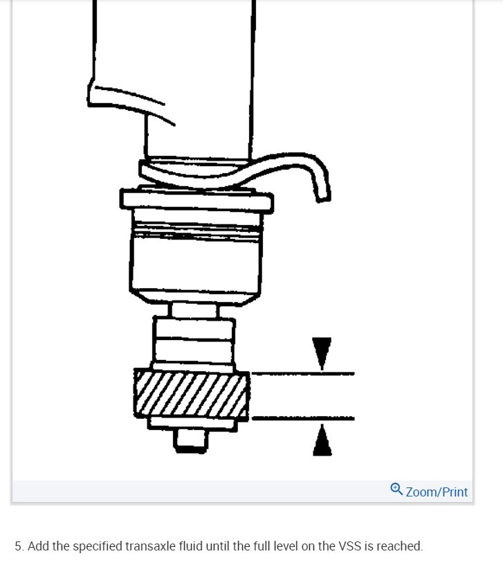

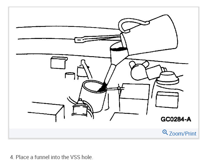

Transmission Fluid Fill
Place a funnel into the Vehicle Speed Sensor (VSS) mounting hole.
Add the specified transmission fluid until the "full" level on the VSS is reached.
Connect the speedometer cable to the VSS.
+1

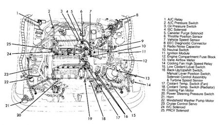

How do find the speed sensor on the transmission?
DAVE H
  • 13,384 POSTS
1.8LOn transaxle, at speedometer cable connection.
1.9LOn transaxle, at speedometer cable connection. See Fig. 2 .
https://www.2carpros.com/forum/automotive_pictures/266999_vss_6.jpg
https://www.2carpros.com/forum/automotive_pictures/266999_AAA2_377.png
