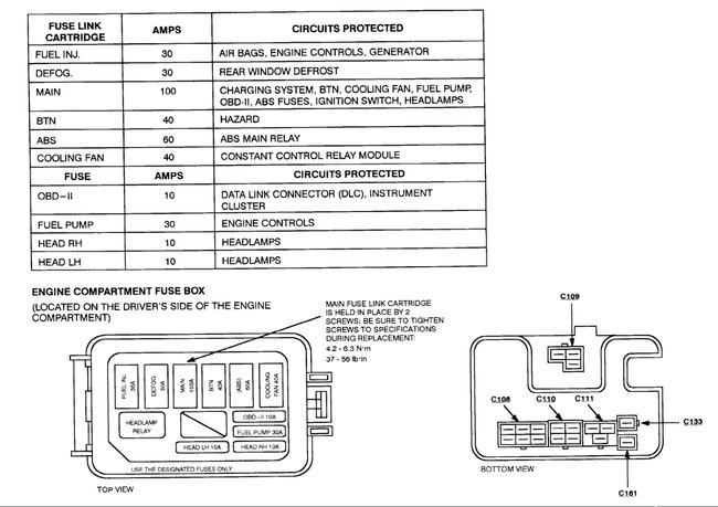

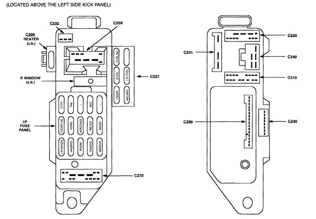

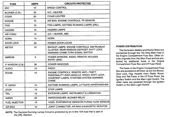

My car keeps blowing out the tail light fuse. I don't have the illustration or owners manual to be able to match with my cars fuse box. Is there any way you can show me a picture of my cars fuse box? There are 2 fuse boxes under the dash on the drivers side. Can you send me a picture or diagram or something?

Here is a guide to help you test the fuses and the fuse panel locations and identification in the diagrams below.
