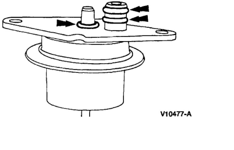

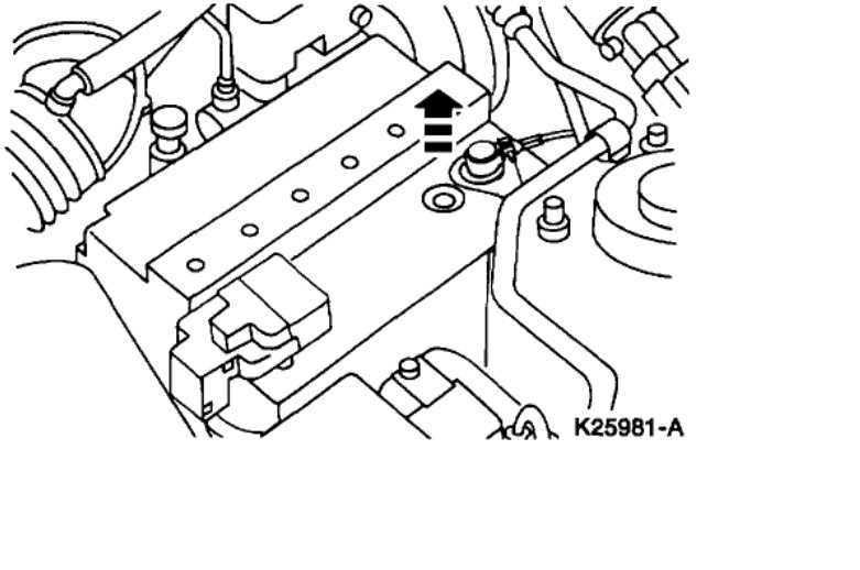

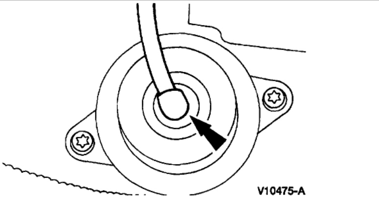

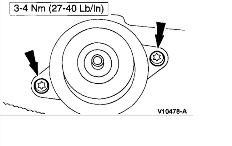

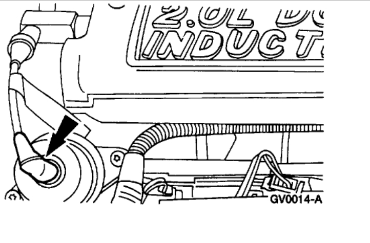

Where is the fuel pressure regulator located in my escort
Aug 30, 2010 at 5:56 AM
  • 55,423 POSTS
The fuel pressure regulator is located in the fail rail at the engine by the injectors. Here is a guide on how to test it and the diagrams below on how to change it out.
