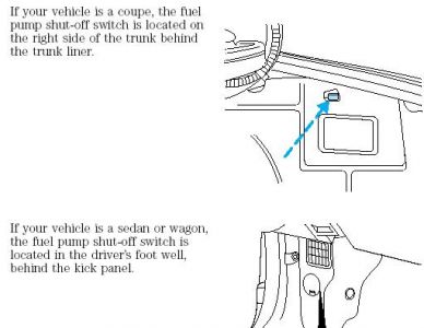

My engine cut out after driving over a large speed bump. It cranks over but will not fire. Can you tell me where to find the cut off switch?
Dec 6, 2009 at 5:29 PM
JDL
  • 16,098 POSTS
Welcome to the forum. Check out the diagrams (Below). Please let us know if you need anything else to get the problem fixed.
https://images.2carpros.com/forum/automotive_pictures/170934_escort_inertia_switch_1.jpg

how do i reset the fuel pump inertia switch?
Dec 23, 2020 at 5:18 AM (Merged)
  • 75,988 POSTS
CAUTION: Do not reset the Inertia Fuel Shutoff (IFS) switch until the fuel system has been inspected for leaks.
To reset the IFS switch, depress the button on top of the IFS switch.

check your inertia (fuel cut-off) switch. on 4-door it is on right side of trunk, under carpet. for 2-door it is on right side of carge area, near wheel well.
