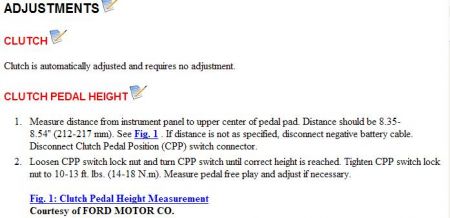

ford escort 1998 16cc 16v
clutch biting point high
can you adjust

Hi there, There is no clutch adjustment only the pedal hight can be altered. mark (mhpautos)

As mhpautos has said there is no actual clutch adjustment .. if the biting point is really high .. then the clutch is due for replacing soon .. just a warning for the future as this is the only real indication of impending clutch problem .. sorry for the bad news
