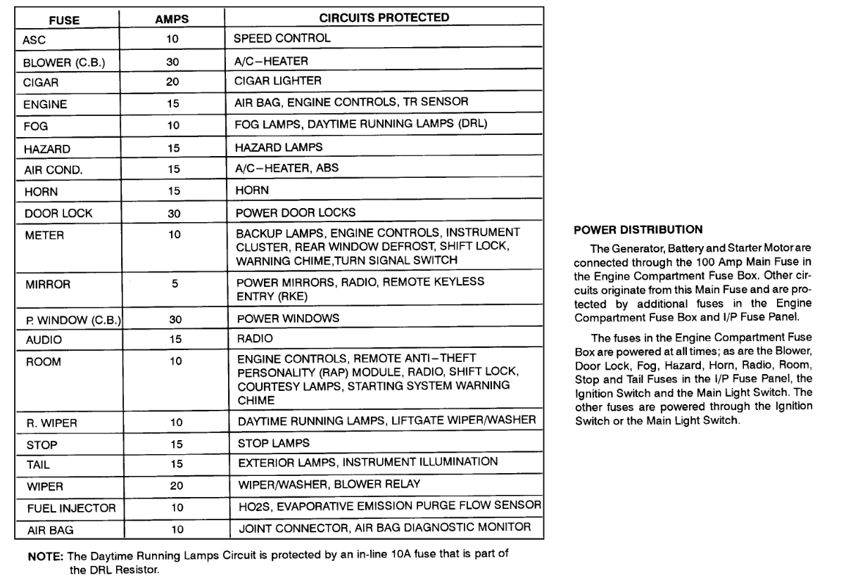

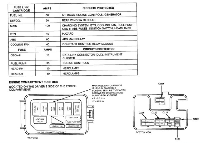

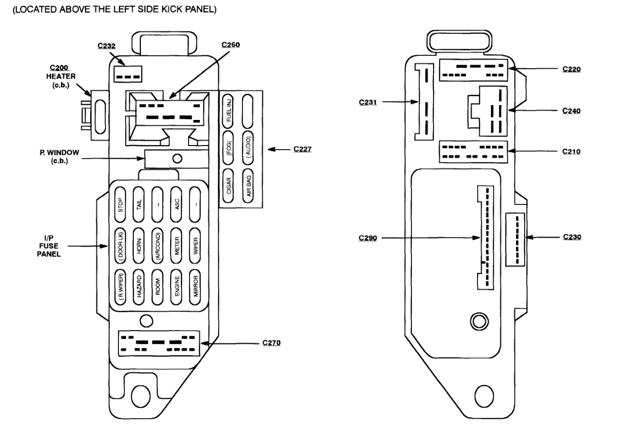

BTN 40 amp fuse in power distribution box
1998 FORD ESCORT
79,000 MILES • 4 CYL • FWD • MANUAL
DHARTLINE12
what does this fuse control?
Jan 12, 2009 at 4:09 PM
ZACKMAN
  • 4,202 POSTS
Here are the fuse panel diagrams below with the guide to help you test them
