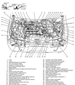

It is a part of the brake switch located on to of the brake pedal.if you have a scanner you can check it by stepping on the brakes while watch data information. you should see it switching from off to on and so on.
https://images.2carpros.com/forum/automotive_pictures/99387_escort97_1.jpg

On the 1997 models four solenoid valves are located on the valve body .
solenoid valve actuate shifting and torque converter lock up by switching oil flow through passages in the valve body.

Solenoid is in at the transmission valve body.
you need to remove transmission oil pan to gain access.
