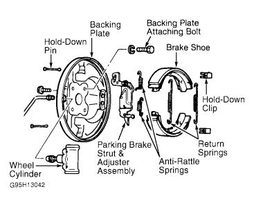

I have replaced the master cylinder and the rear shoes and rear drums and bled the system real good. i have a problem with the rear brakes (chattering) upon applying the brake paddle and it does the same if i use the emergency brakes. The chatter will shake the car. I can't see anything that i have done wrong or see anything wrong with the rear brakes. I check the rear wheel cylinders they are free and do not leak. Can you give me any idea as to how to correct this problem?

sounds like one/both shoe hold down clips has not been put back correctly or has become detached again ??
https://images.2carpros.com/forum/automotive_pictures/266999_brake_3.jpg

Thanks Dave, I will check those CLIPS. Today I also changed the wheel cylinders just to make sure it wasn't them and i still have the same problem. I will check those clips as soon as i can maybe tomorrow.
