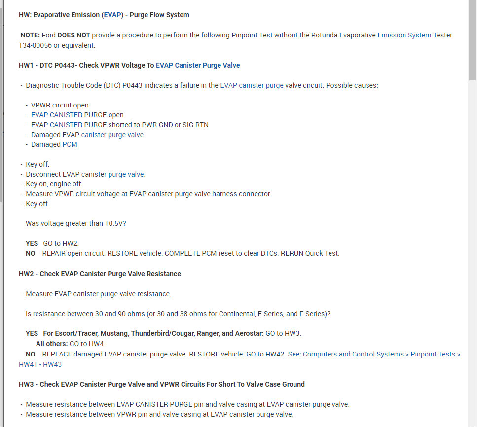

Please let me know the meaning of the following code. My car failed an emissions inspection test. p1443 Please let me know what all of this means?
Jan 11, 2009 at 12:55 PM

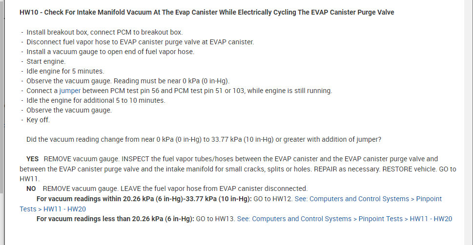

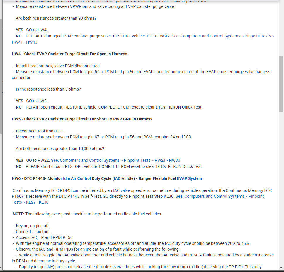

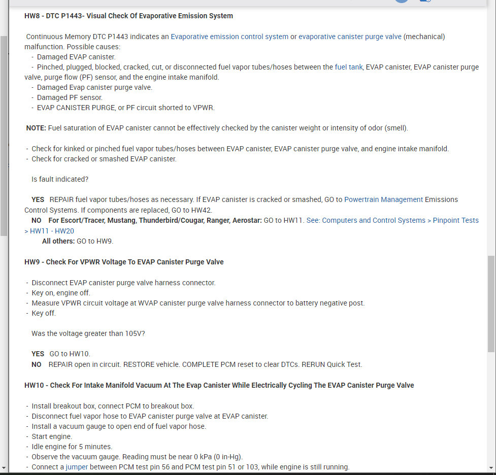

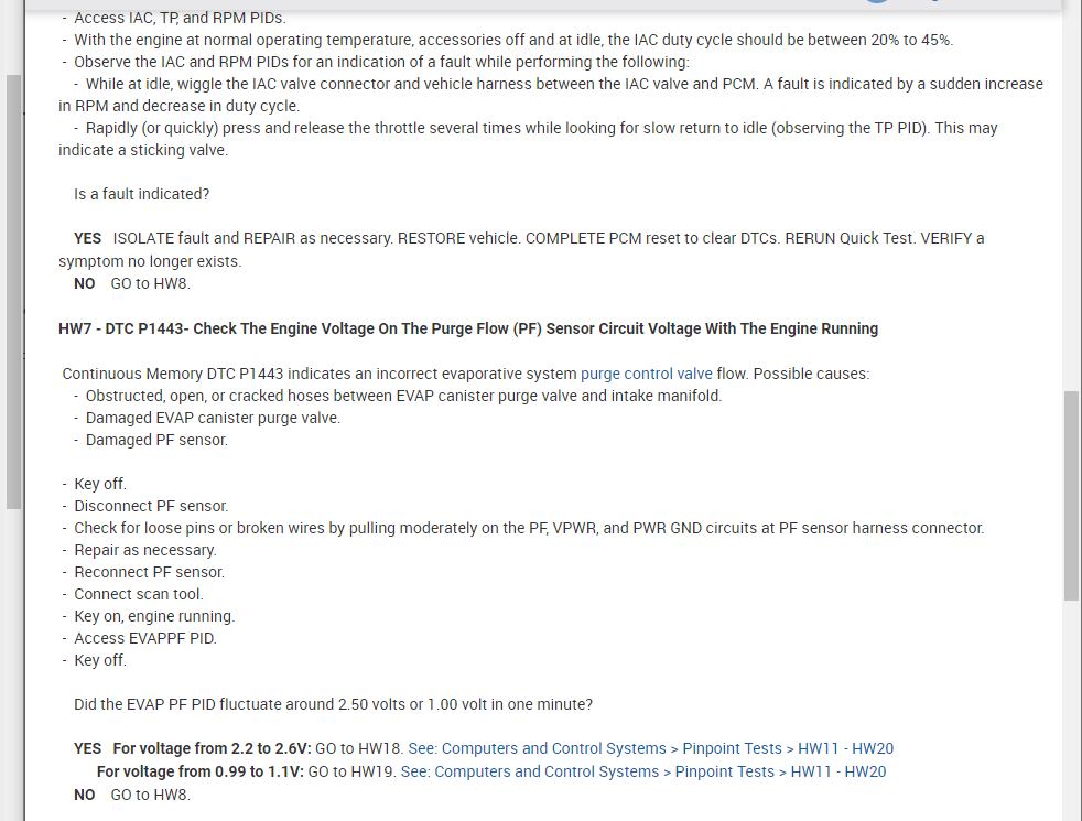

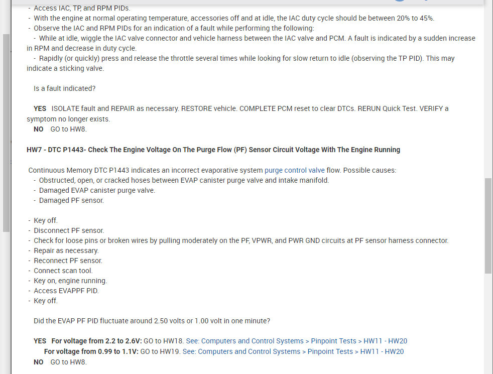

This code is for the purge valve and is a common cause of failing inspections. They fail as a result of fuel getting into the canister and that charcoal breaks down and causing the solenoid to stick.
Here is a guide that will help with this system:
https://www.2carpros.com/articles/how-emission-control-systems-work

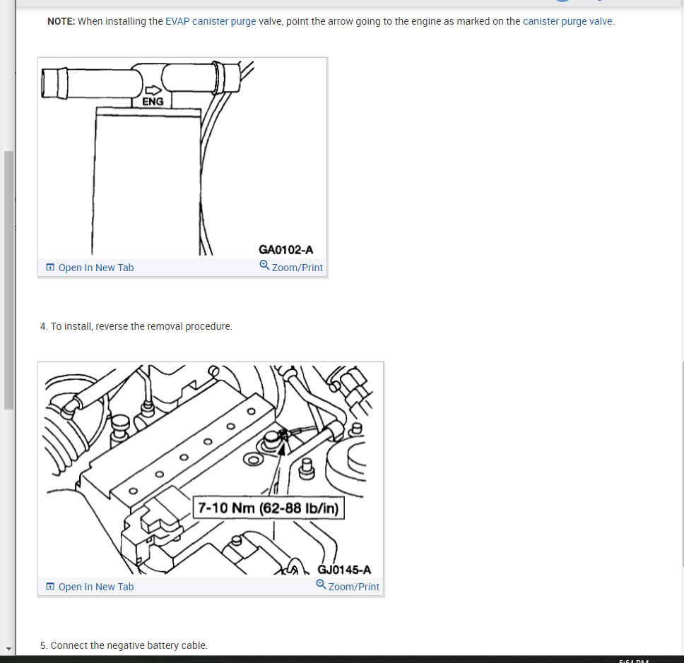

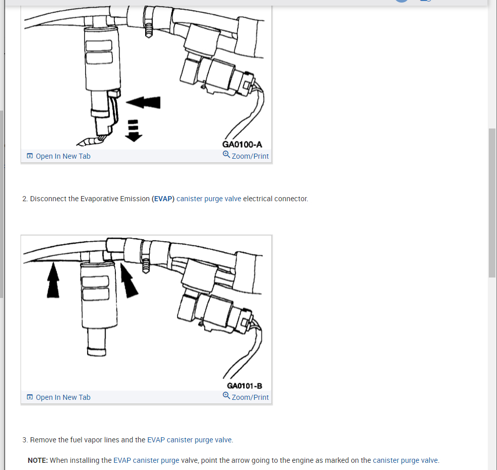

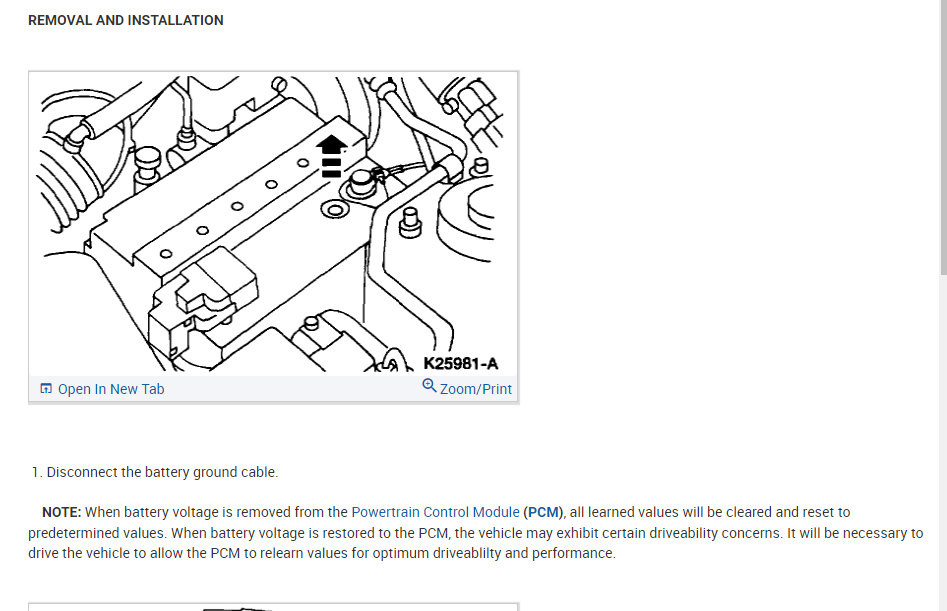

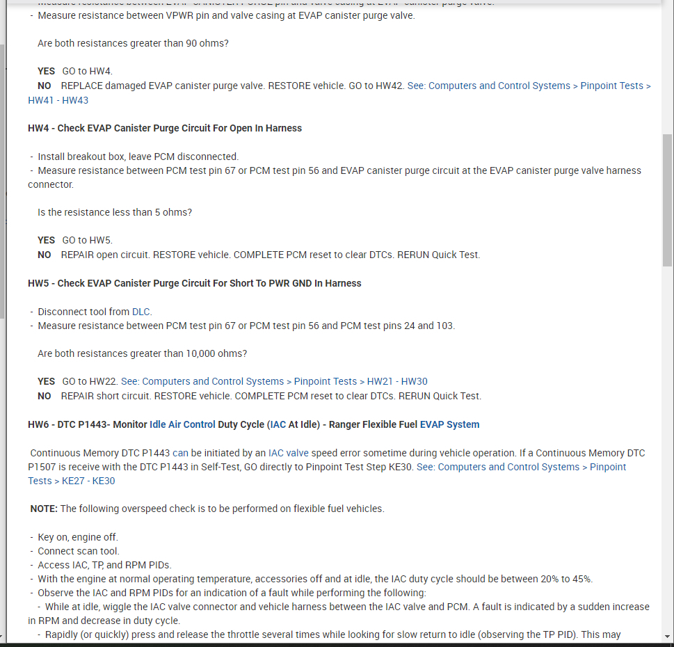

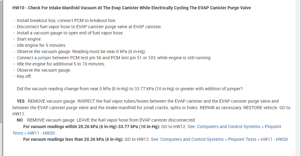

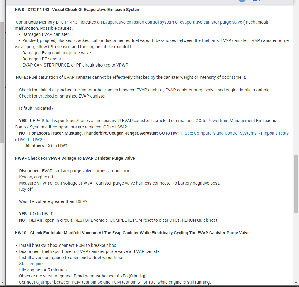

I attached the testing below for your review on this and so we need to run through this testing to find out what the issue is.
However, I suspect this is a purge valve/solenoid issue so I included the process on how to replace it.
Please let us know what you find with this. Thanks
