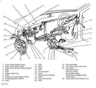

  • 109,709 POSTS
It is behind the left side of the dash behind the kick panel. Here is a picture. It will need enlarged for you to see it:
https://www.2carpros.com/forum/automotive_pictures/249084_resister_2.jpg
Thursday, October 22nd, 2009 AT 1:34 PM

  • 109,709 POSTS
Actually, the it could, but this is how it works. The resister limits the amount of power that gets to the blower motor. The lower the power, the slower the motor spins. At the switch, all you do is send 12 volts to different locations in the resister. Based on which part gets the power determines how much power the motor gets.
I would start with the resister or at least check it for continunity.
Thursday, October 22nd, 2009 AT 1:45 PM
BIGBUCK20
  • 11 POSTS
Thanks for all the help! It was the resister. Got one for $16.00 at the dealer. Everything is now working great! The old one was fried all to hell! This little P.O.S. Just has to make it through the winter then I can get rid of it.
