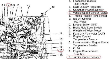

I need to replace my speed sensor. Can you tell me how I know which sensor to purchase without removing the old one first? Thank you.
Jan 9, 2009 at 9:06 AM
BLUELIGHTNIN6
  • 16,542 POSTS
Hello Speed Control Components, Speed Sensor F1KY9E731BA 83.71 The Vehicle Speed Sensor is located at the lower rear of the transaxle. Your vehicle is equipped with both a turbine speed sensor and a vehicle speed sensor. The turbine speed sensor is located on top of the transaxle (see figure 1) and the vehicle speed sensor is located on the lower rear of the transaxle (see figure 1) FIGURE 1
https://images.2carpros.com/forum/automotive_pictures/261618_Noname_99.jpg
Use a meter to test the sensors for correct power. Hope this helps... Thanks for using 2carpros.com !
