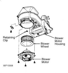

1996 Ford Escort Two Wheel Drive Manual
how to change heater filter and heater fan motor
Mar 14, 2009 at 12:31 AM
DAVE H
  • 13,384 POSTS
BLOWER MOTOR Remove panel under glove box. Remove wiring bracket and bolt. Remove 3 blower motor mounting bolts. Pull blower motor out of housing, and disconnect wiring. See Fig. 5 . To install, reverse removal procedure. Fig. 5: Exploded View Of Blower Assembly Courtesy of FORD MOTOR CO.
