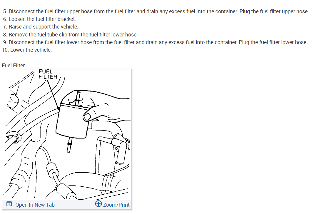

This happened before. Put some fuel system cleaner in and it was fixed. The vehicle sat for several weeks lately. It started happening again. I have put fuel system cleaner in. It got a little bit better. But, when the engine is warm, it stalls at idle or when I come to a stop. It was hesitating. But, that has stopped. What do you suggest?

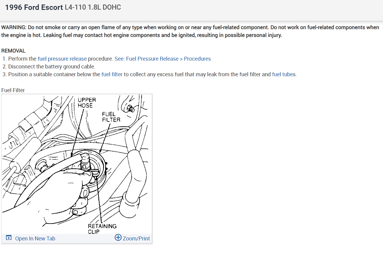

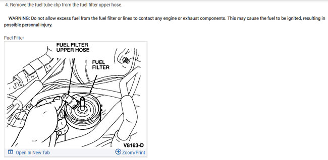

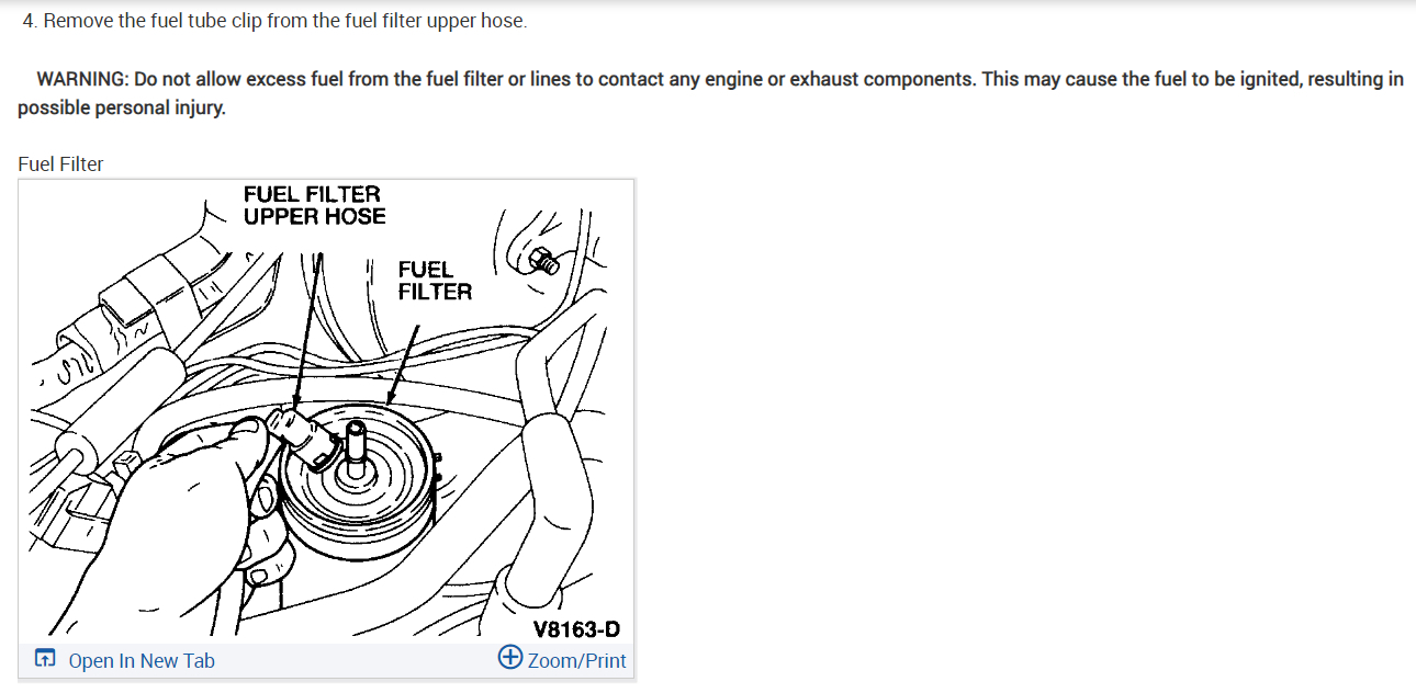

I'd start with a new fuel filter. Wouldn't hurt, and cheap. Then hook up a pressure gauge to the fuel line and let me know what it reads.

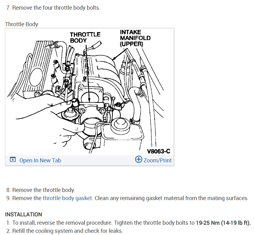

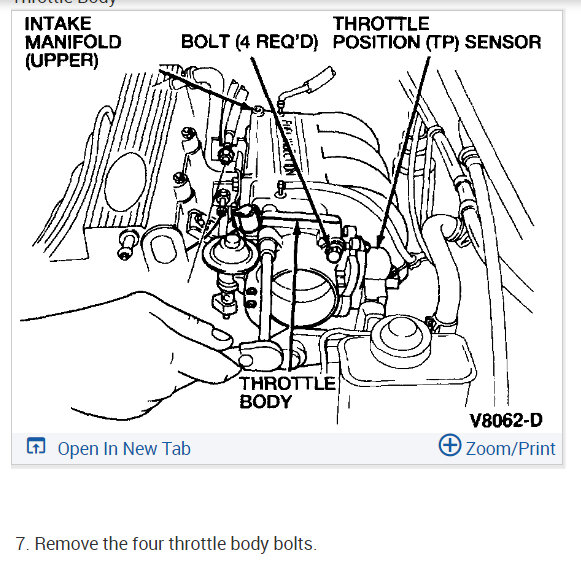

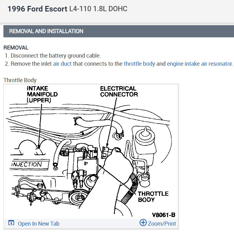

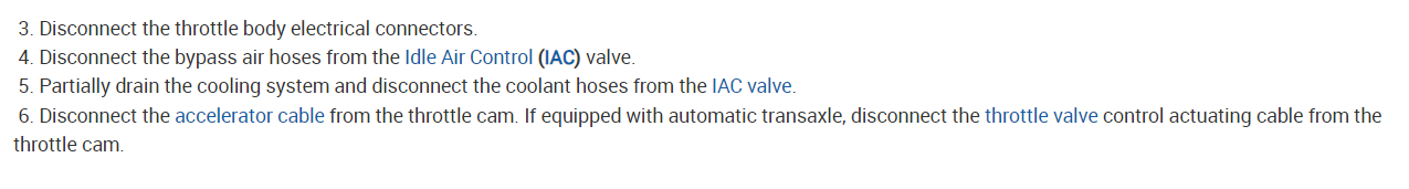

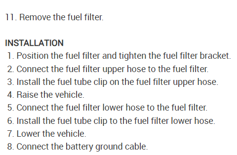

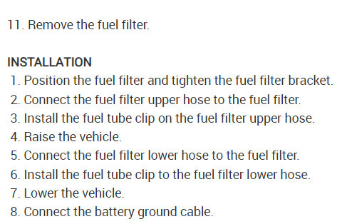

I have seen the throttle body service cause this issue, here are two guides to help us fix the problem and I have included instructions for your car in the images below.
https://www.2carpros.com/articles/engine-hesitates
and
Also, here is the location of the fuel filter as well. Check out the images (below). Please let us know what happens.
