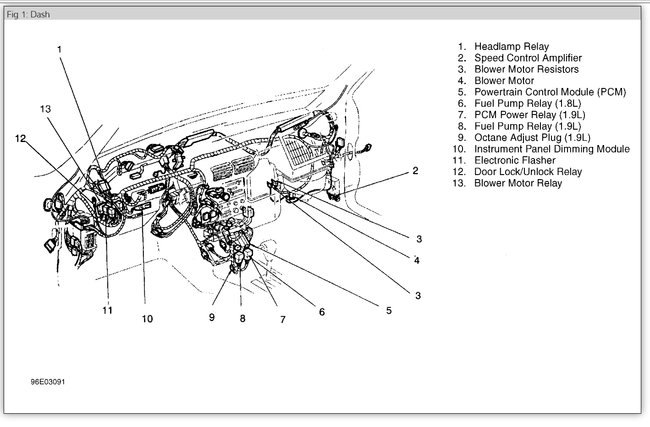

JERZ3455
Hi.
Just recently (two days ago) I experienced the same issue. Started my vehicle. Made it out the driveway and it cut off. Same scenario as Richardgriffin01.
Replaced pump. Old pump was still functional, turns out no power to fuel pump.
Checked IFS. Reset it and reset it again. All fuses are intact. Looked aimlessly for the location of the actual fuel pump relay. On this specific model, it's 'supposed' to be located in the center console underneath the ashtray, but i honestly don't see it.
Can anyone possibly direct me there? Where is it exactly?
Thanks
Nov 23, 2019 at 3:48 AM (Merged)
  • 55,588 POSTS
Hey Guys,
I found thi diagram showing where the fuel pump relay is located.
Please let us know happens so it will help others.
Best, Ken

DOUGROLL!
We started out with a no fuel situation. We replaced the fuel pump and fuel pump relay to find out that wasn't the problem. After actually testing the fuel pump relay and finding out that EEC powers the fuel pump relay, We tested for voltage for the EEC relay and no voltage from the ignition was present. The engine cranks but will not start. I've checked the fuses and they seem good. I spoke with a friend about it and he thinks it could be a solenoid fuse link but I can't find one.
ANY IDEAS
Doug
  • 75,988 POSTS
For what liter engine?
DOUGROLL!
The Ford Escort is a 1.9L
check this diagram
DOUGROLL!
Although the diagram and wire color coding is somewhat different than the one I have From Haynes, it promted me to recheck the fuses again. I have power to the fuse box in the engine compartment and none of the fuses are blown and none are blown inside the vehicle. On my diagram it says meter from the I/P fuse panel to the EEC/PCM relay, so I pulled the fuse labeled meter and checked for voltage with the ignition in the on position and found no voltage. On your diagram it said engine from the I/P. I checked that with ignition in the on postion and no voltage. Your help is greatly appreciated.
Doug
is the marked fuse on the diagram hot on both sides
DOUGROLL!
When I pulled the fuses in the engine compartment and check either side of the prongs, only one side was hot. The inside I/P fuse panel I checked where the plades went in on both sides and no voltage with ignition in the on position. I also checked for continuity between engine/meter fuses to EEC relay and there was a connection on both sides!!!
Doug
