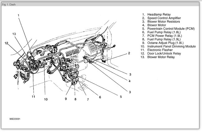

JERZ3455
Hi.
Just recently (two days ago) I experienced the same issue. Started my vehicle. Made it out the driveway and it cut off. Same scenario as Richardgriffin01.
Replaced pump. Old pump was still functional, turns out no power to fuel pump.
Checked IFS. Reset it and reset it again. All fuses are intact. Looked aimlessly for the location of the actual fuel pump relay. On this specific model, it's 'supposed' to be located in the center console underneath the ashtray, but i honestly don't see it.
Can anyone possibly direct me there? Where is it exactly?
Thanks
Nov 23, 2019 at 3:48 AM (Merged)
  • 55,423 POSTS
Hey Guys,
I found thi diagram showing where the fuel pump relay is located.
Please let us know happens so it will help others.
Best, Ken

  • 110,244 POSTS
The fuel pump is in the fuel tank, and the relay is under the hood in the power distribution box. As far as the relay, you can just switch it with another one with the same part number to see if that helps. Also, I want you to do the same with the EEC relay to see if that makes a difference.
As far as checking the fuel pump, you need to check it for pressure. Here is a how to for checking it.
https://www.2carpros.com/how_to/how_to_check_fuel_pressure.htm
Let me know what you find. Also, check to see if the engine is getting spark to the plugs. If you lost both fuel pressure and spark, the EEC relay is most likely the problem.
